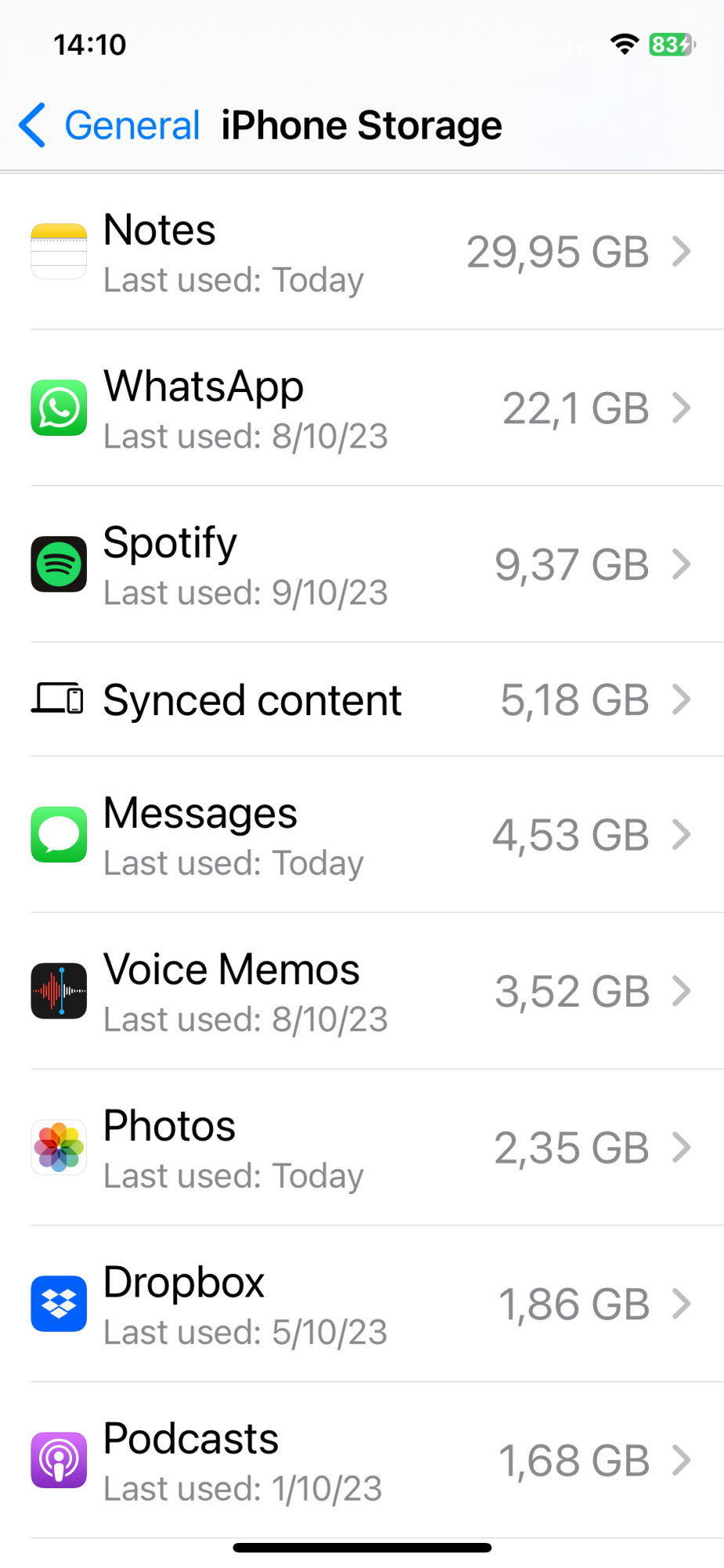

Unhappy to report that restoring from an encrypted backup on the Mac did not solve the problem.
Space taken by Notes before:
Space taken by Notes after:
Still near 30GB.
Also, Photos storage is still reporting too much space - sign of phantom photos as well as phantom Notes.

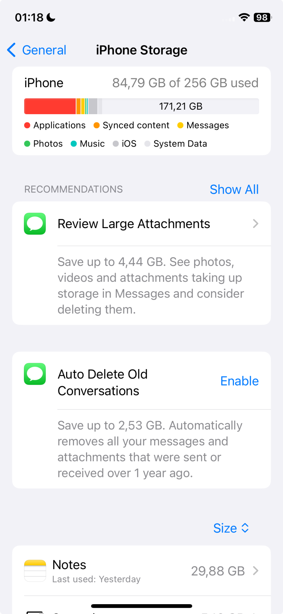

I did the iCloud restore.
It seemed to work for a while, the Notes app showed less than 0,5 GB occupied space.
I rebooted the iPhone and use the Notes app a couple of times, then boom:
This seems to be some shenanigan somewhere that it is kind of hidden deep in the app or the system.
Again, in my new phone, fresh installed, Notes takes only 374 MB. That's all, and that is accurate, in line with space reported by the same Notes in my iPads and Macs.
I will just erase this old phone and hope the 30 GB of Notes do not reappear in my brand new iPhone.
So no solution for this thing, at least so far. If anyone has ideas please let us know.
