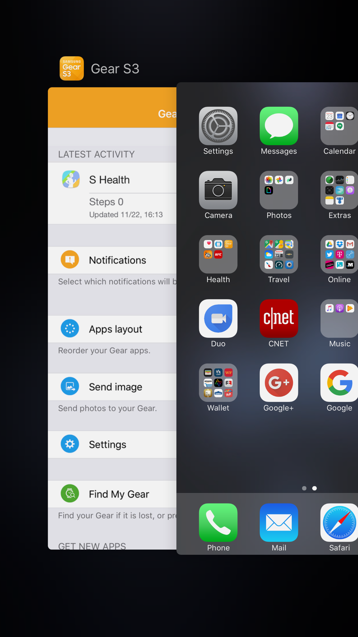

The app must remain open in the background on your phone. This is how I always have mine. See pic below.

Thanks again for the info. I have the app running in the background, and it will disconnect and reconnect pretty constantly. I was chalking it up to it being a beta.
