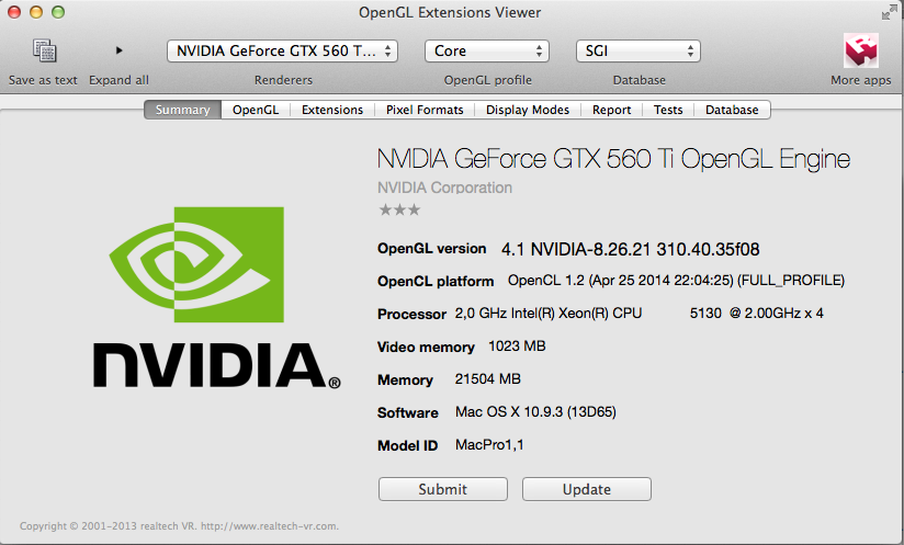

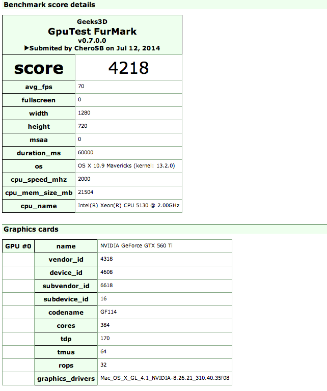

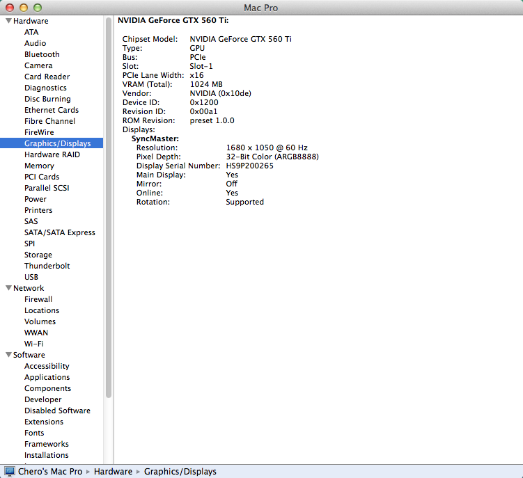

I just a yesterday succeed make to work 560ti in may MacPro.
Im make clean instal of Lion 10.9.2 make upgrade to 10.9.3 put kext and
repair boot.plist and after that all be good, very good 🙂
After Im ugrade to 10.9.1 all be fine 🙂 And Now Im on 10.9.3
