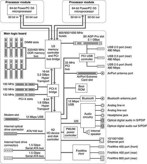

BTW, if someone wants to continue to insist that the MDD is like a G5, hopefully the block diagrams of the two will show that they are actually nothing alike
