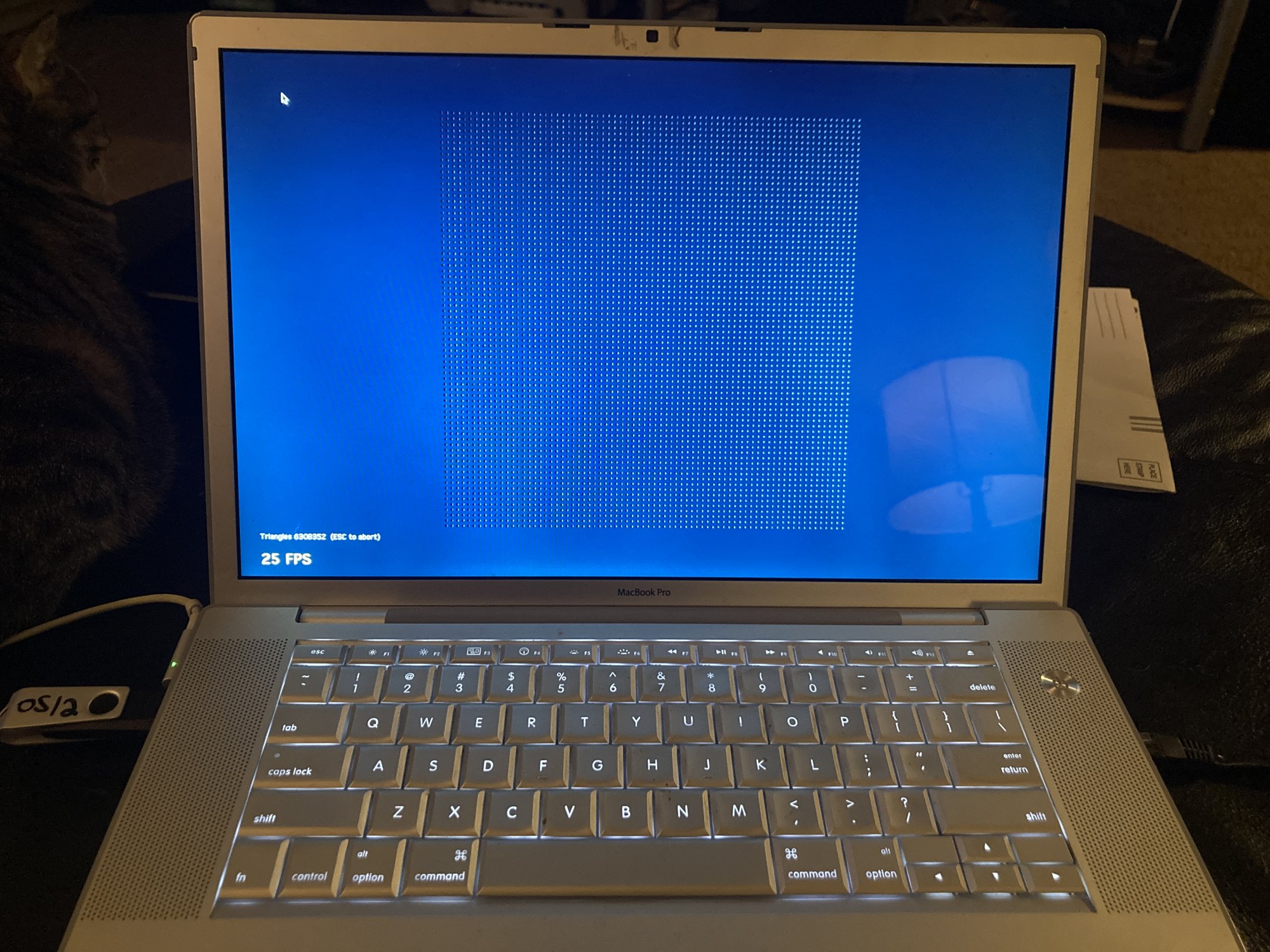

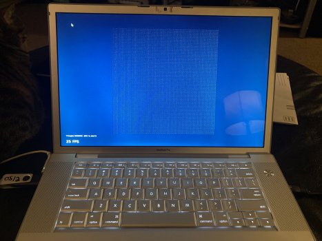

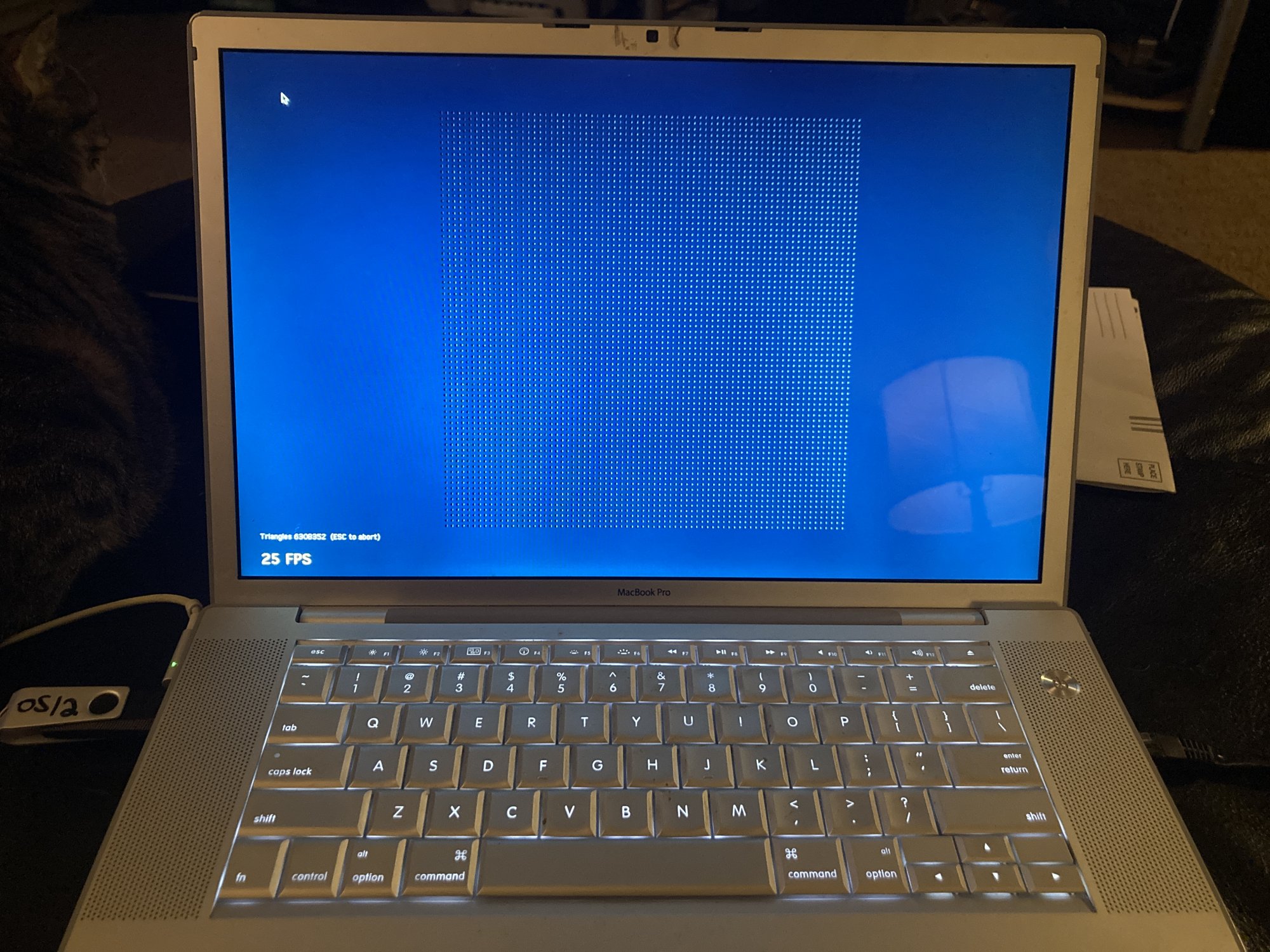

I’ve booted into Snow Leopard and am running openmark. It seems to be fine? I’d imagine a benchmark like this would cause a failed 8600m to act up would it not?
Edit: was posted on mobile, fixed the image being posted mid-sentence.
