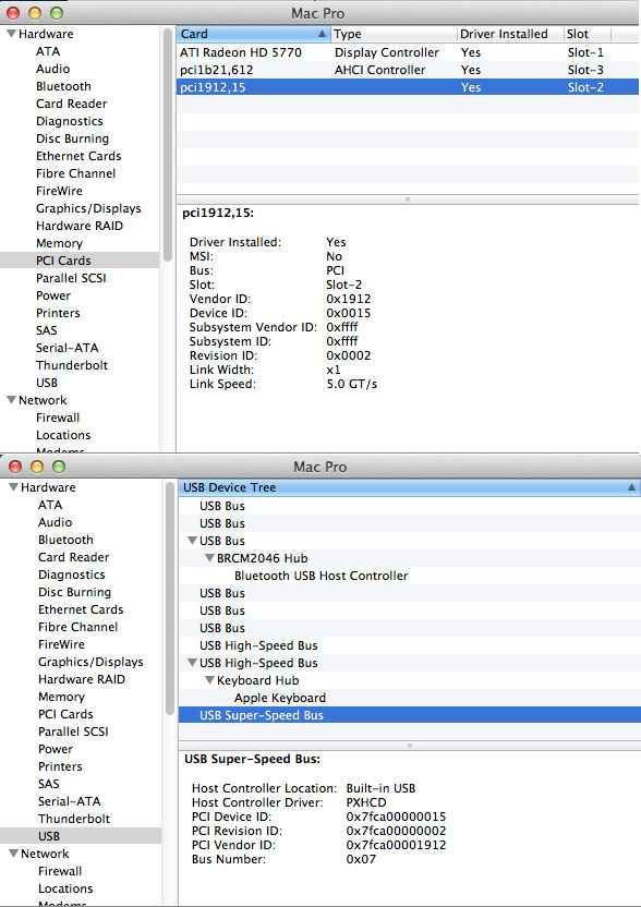

Here's a screen shot of my System Info, the WD drive is plugged in but isnt working.
And AHCI Controller is my ASM1061 eSata/Sata card.
