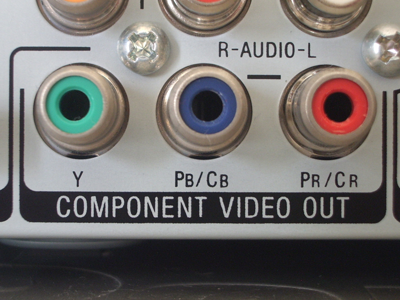

Component is not the same as RCA.

3. Just to complete this post for future readers, those interested in a component connection, you will also need a converter. You're not going to get away with $30 though. Don't even bother looking at all those VGA to component cables out there... they will not work on your Mac... nor on most any computer for that matter. I have seen some cheapie converters recently as low as $80, but typically they have been priced in the $150-$250 range.
