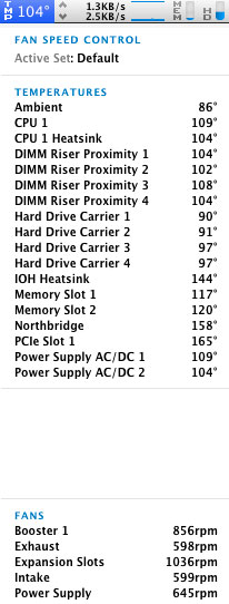

I did find a decent amount of dust when I opened the machine and removed most of it - I will try looking at the card too. I now have the cover on and *touch wood* have not had the displays go to sleep yet.
Btw - I downloaded iStat Menus and if you are up for it - could you kindly compare my temperature readings with your machines? I just want to make sure I'm not taking risks by letting the machine run for a bit until I can get it looked at.
I've attached a screengrab.
Thanks again.

Here you are, for comparison.. machine is idle, temps are in F for you.
Ambient ... 70
CPU 1 ... 90
CPU 1 Heatsink ... 84
DIMM Riser Proximity 1 ... 82
DIMM Riser Proximity 2 ... 84
DIMM Riser Proximity 3 ... 90
DIMM Riser Proximity 4 ... 90
Hard Drive Carrier 1 ... 66
Hard Drive Carrier 2 ... 73
Hard Drive Carrier 3 ... 75
Hard Drive Carrier 4 ... 70
IOH Heatsink ... 115
Memory Slot 1 ... 88
Memory Slot 2 ... 90
Memory Slot 3 ... 86
Northbridge ... 133
PCIe Slot 1 ... 79
Power Supply AC/DC 1 ... 77
Power Supply AC/DC 2 ... 75
Fans
Booster 1 ... 856rpm
Exhaust ... 599rpm
Expansion Slots ... 799rpm
Intake ... 599rpm
Power Supply ... 599rpm
Now I should add that there is at least one difference between your machine and mine... I have replaced the stock cooler on the 5870 with one with three fans. The stock cooler helps vent air out of the case whereas mine just circulates the GPU heat into the upper PCIe bay so the Expansion Slot fan will have to do more work under load.
If you have a RAID card it will push up the heat in that bay too.
EDIT : comparing our temps (and adding 15F as a quick adjustment to the difference between our Ambients) I can see that all of your MP is working well except for whatever is in the Expansion bay.
