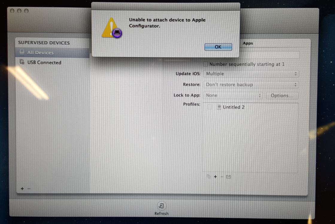

To the best of my knowledge relevant certificates, and provisioning profiles are installed on the MacBook, however I see the message below in Apple Configurator 1.0 -

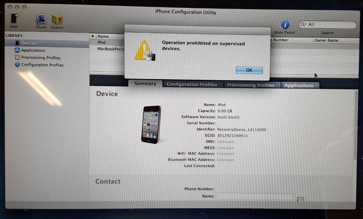

Furthermore when using the iPhone Configuration Utility I see the message presented below -
I believe that the installation id of OSx has changed and as a result the iPods no longer recognize the MacBook and reject attempts by it to program them. However hopefully I am wrong about this!
I am now wondering is there any way at all to get access to my iPod fleet? For example are there additional steps which can be taken on the MacBook which will allow me to regain access, or is there some way of factory resetting the iPods so that I can start fresh with them (currently it doesn't even seem possible to turn them off with the power button).
