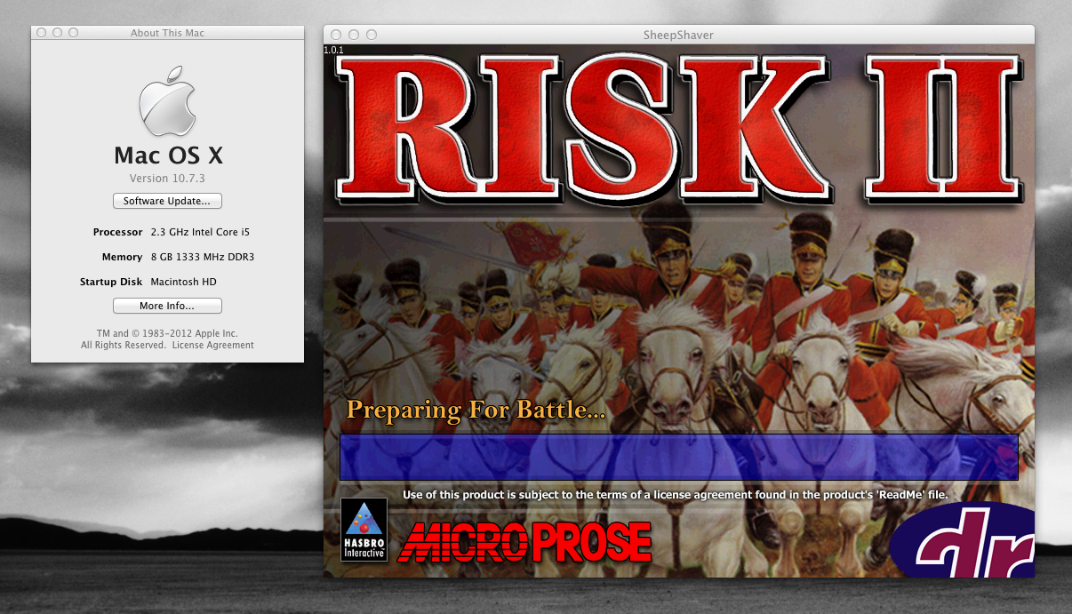

I also avoid bootcamp, but it seems that no one here has discussed VirtualBox, VMWare, or Parallels as an option to run the Windows binaries for Diablo II virtually in OS X. This game is so old, and so un-demanding of modern hardware, it should run smoothly enough, no? I had Starcraft running in a virtual machine at full speed just fine before I finally cracked the nut and got it working correctly in a Wineskin.
