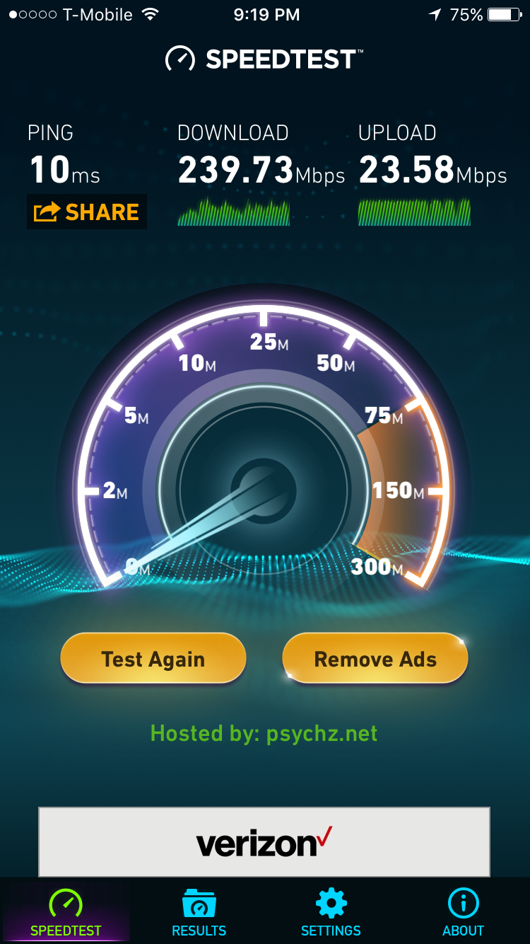

the 6s and 6s+ have MIMO antennas, you should be getting good speeds assuming you don't have other devices taking up the bandwidth. Wifi speeds on iPhone is NOT slow, and the speedtest app is definitely not limited to 50Mbps.
yes. these iPhones were the first ones to have 3 x 3 spatial streams.
