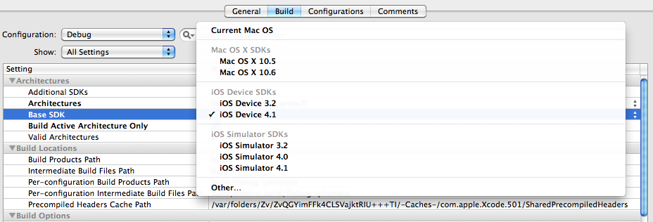

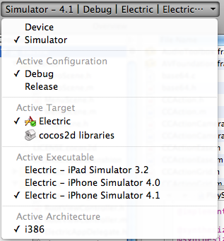

um, you could have just redesignated it from Device to Simulator on the main XCode window in a dropdown.
If you don't have that option, you just need to tweak one setting in your build options by right-clicking on the project and hitting "Get Info"...

Tried that, and was receiving the error message even with simulator option. Tried many other things including removing Xcode completely & reinstalling, different devices, etc. Spent a fair amount of time researching and trying different suggestions. Again, a week of dinking around was a week lost. Sucked, but no more gremlins.
