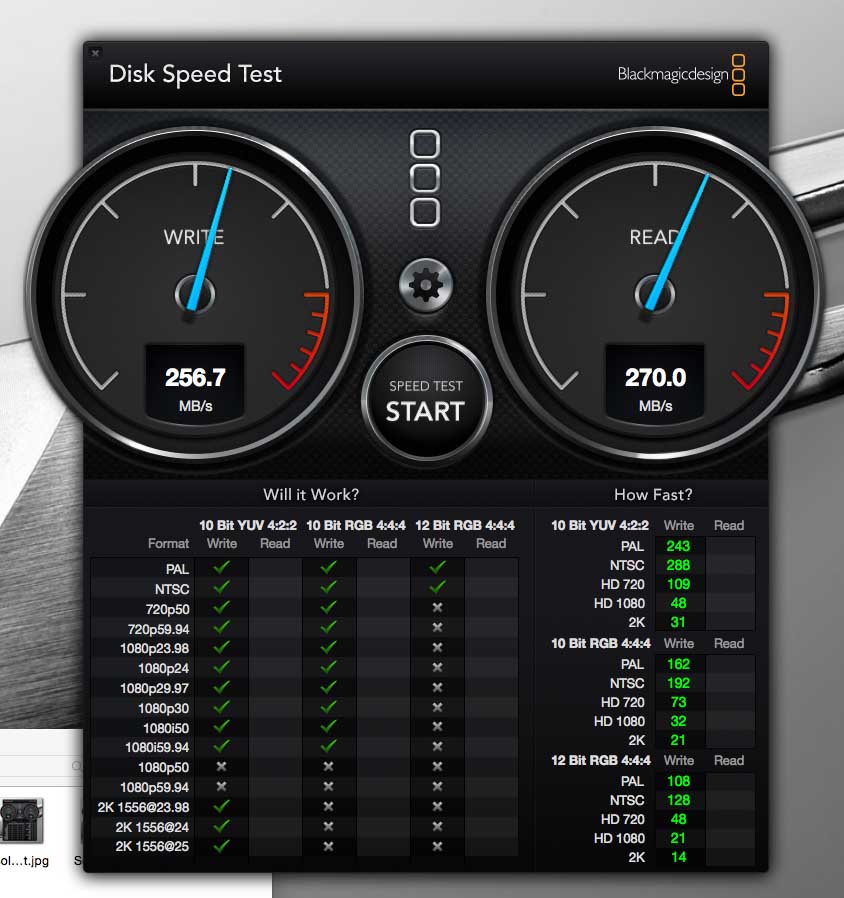

I'm under no illusions that I'll get the full 300MB/s that SATAII is rated at, but 150MB/s write speed seems too low. Am I managing my expectations appropriately, or is 150MB/s standard fare for the 1,1 with the SSD installed in a drive bay with the NewerTech Adaptadrive?
I'm getting here speeds with a Samsung EVO in my 5.1 cMP in a drive Bay.
