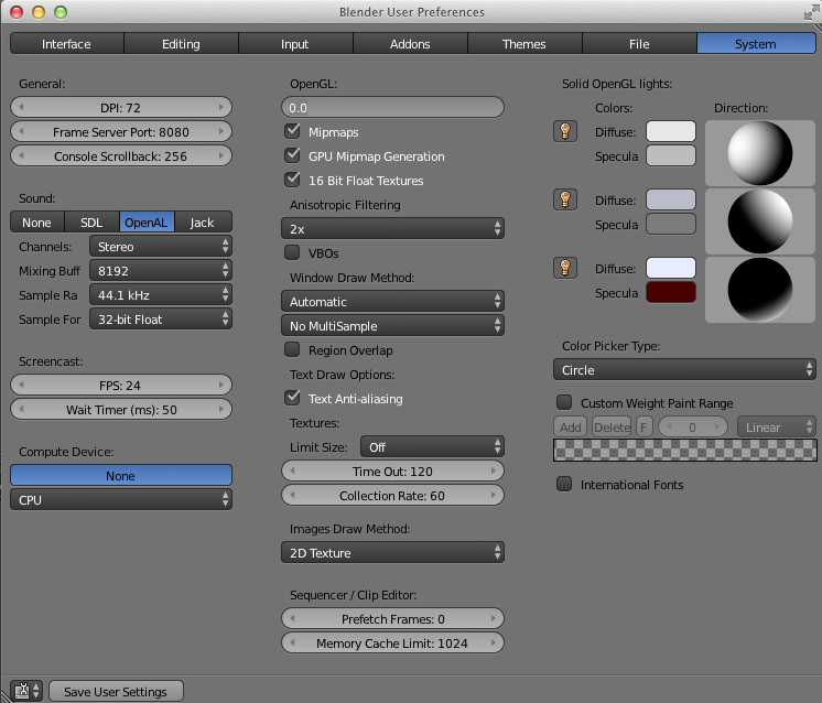

Interesting. Blender also looks to see if the card is CUDA equipped and it can't find anything either:
