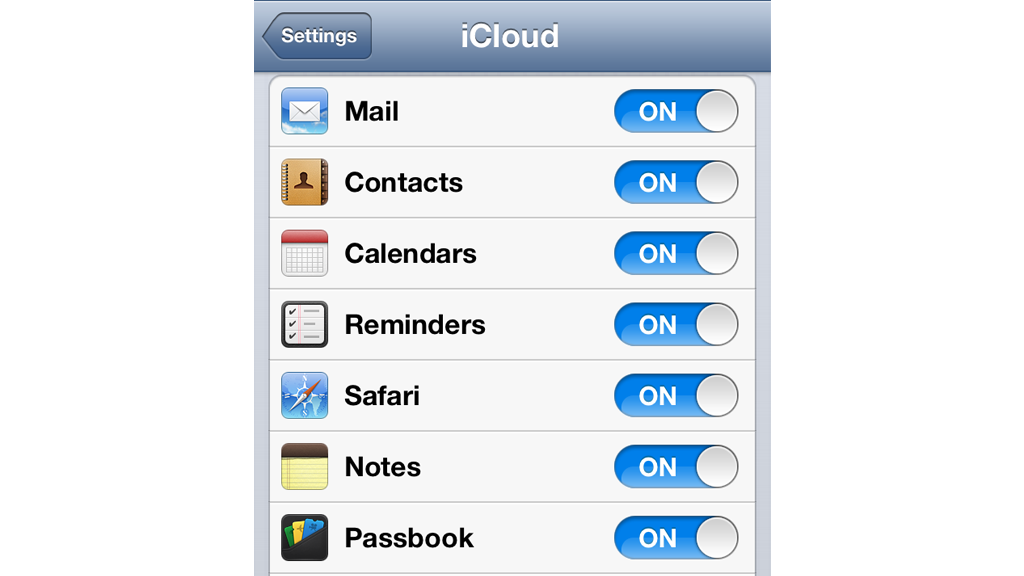

Is there ANY way of getting, say, my contacts back?
When you go through the set up process on the phone it will ask you if you want to enable iCloud (this is separate to the restore from iCloud backup screen!). Say yes, and your contacts will be brought down from iCloud when you get to the home screen.
As long as you had the Contacts tab under iCloud settings set to on, they will be stored to iCloud.
Aha!
Great!
Good job I enabled that before i backed up!
