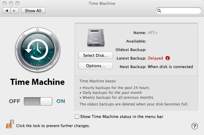

Yeah that is weird. Usually if your backup drive isn’t connected, it just won’t do anything until it is. Maybe your computer THINKS it’s connected, so it tries to do backups and fails? Maybe plugging it in and then ejecting it and unplugging it would work. Can you post a screenshot of your Time Machine Preferences window? (If you don’t already know, to take a screenshot, either use Grab in your Utilities folder or press cmd-shift-4 to bring up crosshairs to select an area for screenshot, and then press the spacebar to switch it so it’ll take a shot of whatever window you click).

that is exactly the way it used to work in Leopard, thought this could be a SL 'feature', but apparently not. please find my tm prefs enclosed. Thanks!

Hm…have you successfully done a backup yet since installing Snow Leopard? That screenshot would seem to suggest not. It looks, from that picture, like you turned on Time Machine, but it doesn’t know what drive to do backups on. Next time your Time Machine drive is connected, click the “Select Disk” button in the Time Machine preferences and be sure to point it at the drive.

Yes i have, when my TM disk is connected, backups work perfectly fine!
