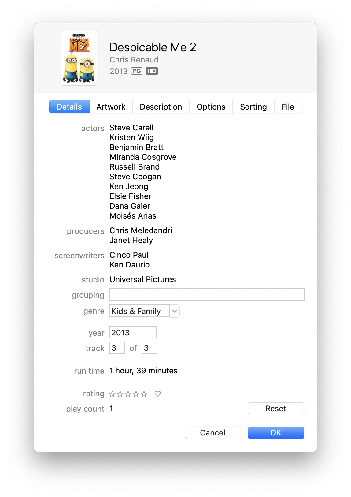

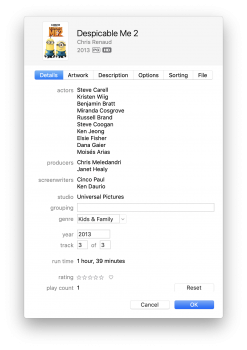

By "tagging" I was referring to the "genre"... go to the movie and tap CTRL+I (Get Info) and then create new categories under GENRE. There are pre-set categories, but you can add your own... then you can sort/display your library by Genre and have what the OP was asking for.

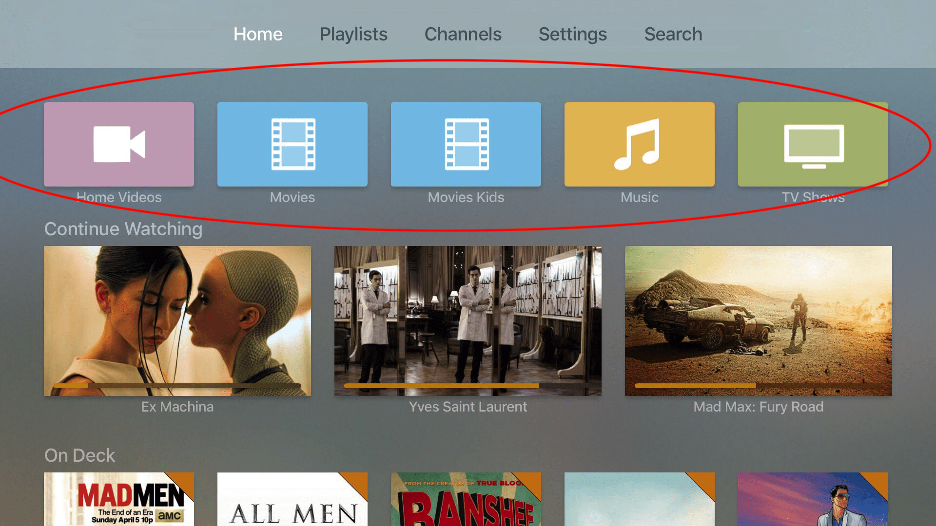

I thought the OP wanted to create categories of media, like Movies, Home Movies, TV Shows, Music, Podcasts, etc. Not tagging genres.
For example, look at this Plex screen shot:
The categories in the in the red circle can be custom to whatever the server owner wants, and as many as the user wants. What I like about this, is that server owner can control what the users have access to.
Using the screen shot above, if I do not want my children to view the category "Home Videos", when I set up their user profile, I can restrict access to it. They wouldn't even know it is there, as they will only have categories that I granted them access to.
If the OP wants to view content containing only education movies, tagging genres is an option, but when looking at a list all the movies, this will include everything unless it is filtered. If there is a category named "Education", then this could be totally separate from "entertainment" or "Instructional" movies, instead of being lumped all together.
This is how I would want it based off the the information given by the OP. This can easily be done in Plex, but not in iTunes.
