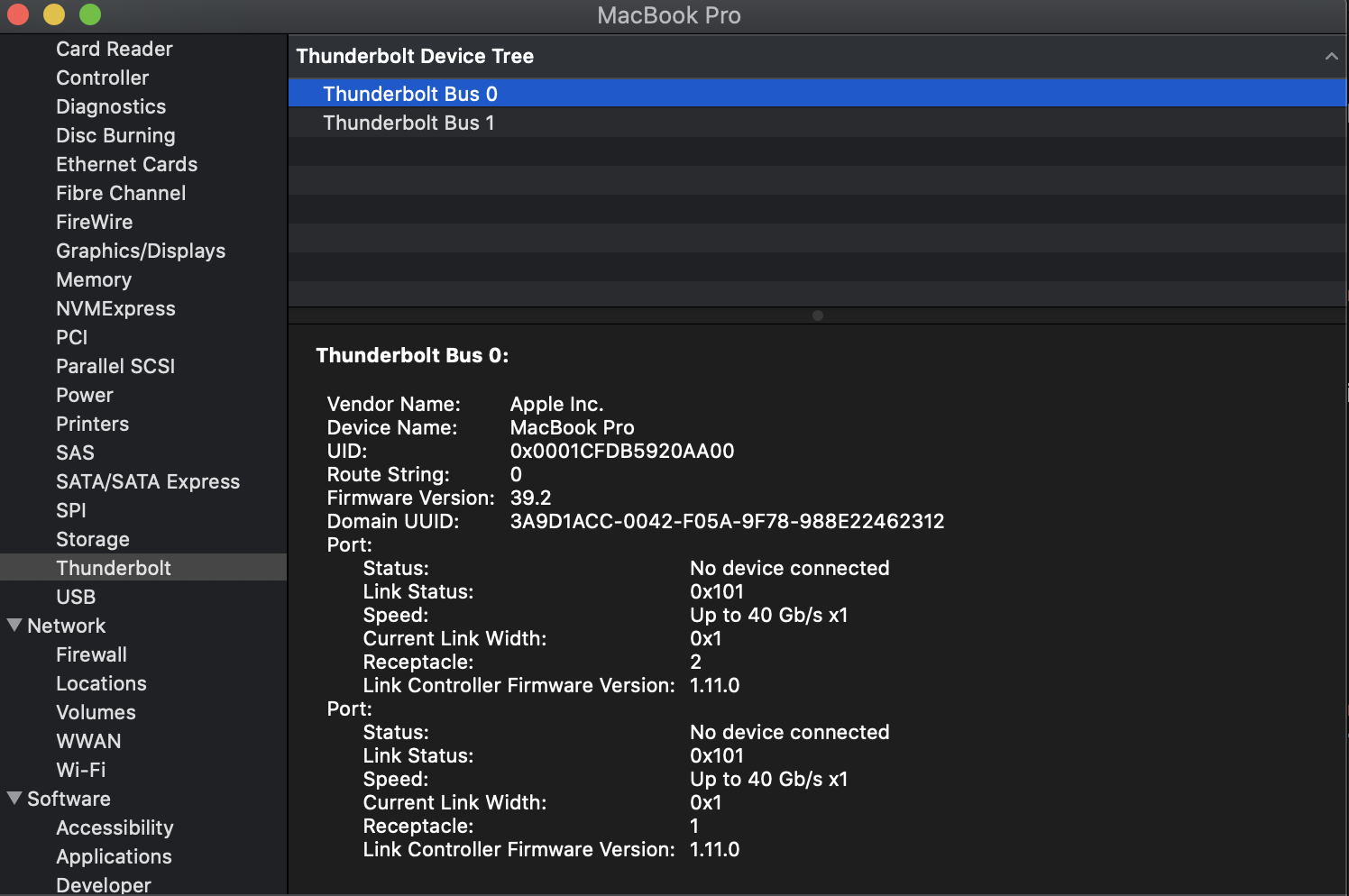

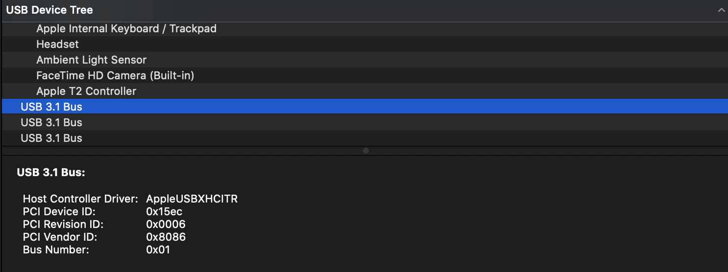

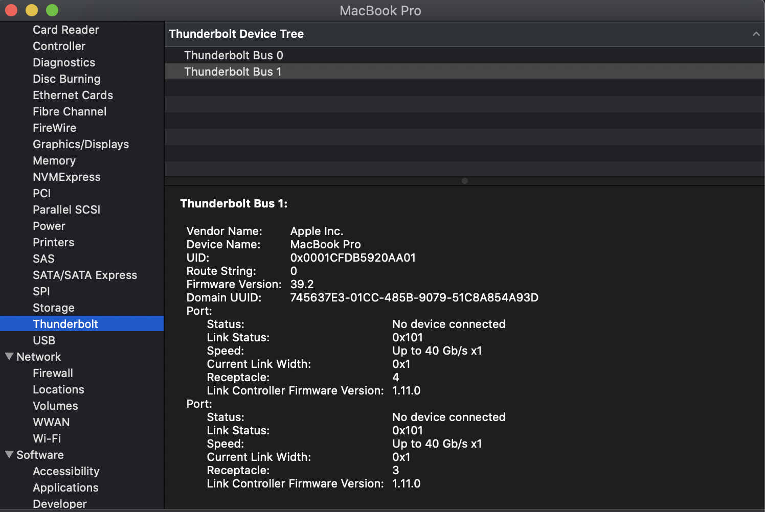

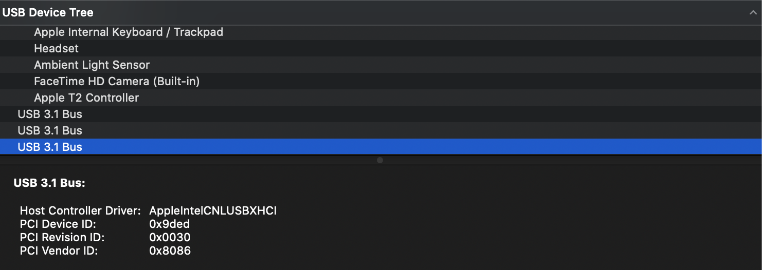

A thought I just had was to run the System Profiler and see if the adapter shows up. I don't think it is, but most of my experience with doing this kinda thing was on an old 2006 Mac Pro tower, so, for example given, I don't know if Apple treats the USB-C ports as USB or Thunderbolt in the profiler. I've taken some screenshots, hopefully they can help with this.
This and the middle "USB 3.1 Bus" listing are identical, except for the bus number being 0x00 on the second.
This one is different but I confess I can't make heads or tails of it, or the previous ones really, I'm a graphic designer Jim, not a Hexidecimal Serial Hardware Reader.... Guy. Unlike other Macs I'm not seeing anything plugged into them, which, at the time of taking these screenshots the only thing I plugged in was the thunderbolt adapter for testing purposes.

The Thunderbolt ports look much the same way, where there's no device connected.
Ultimately this makes me think I got a bad adapter, but before I run back and forth to the store again I just want to make sure I'm looking at the correct logical ports - this adapter SHOULD show up in either the Thunderbolt or the USB listings, right? It wouldn't show in any of the other hardware listings, should it?
