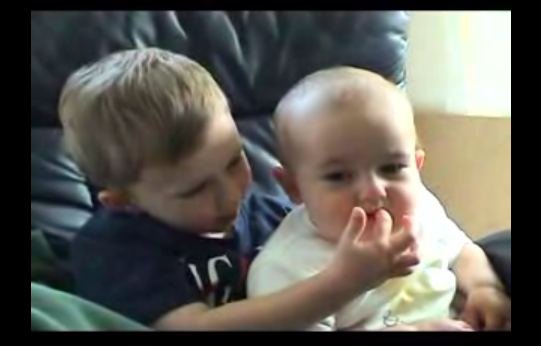

I'm sorry but you're wrong. He didnt ask how he could get the "digital" look, he asked for the cinema look. Look at any movie that plays in theatres, no matter what it was shot on, the contrast on almost all of them is lower(it varies of course depending on whether its an action/comedy/horror etc.) then non-professional videos that were done poorly.
Example:
This is professional footage, notice the very low contrast
Compared to this, home video
Obviously adjusting contrast has to do with getting a cinema like look. Of course everything starts in the camera, you have to have steady footage, proper lighting, etc. But post plays a big role as well.

heron88 is mistaking the low latitude of video cameras for high contrast (even though it only covers about 4-5 stops of light)...
please go watch Sin City and tell me that it's "low contrast".
The proper way to get video to look more like film is to light the scene properly (like I said before) and take into account video's lower latitude. It is not a good idea to just shoot it and lower the contrast in post.
