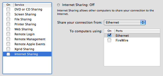

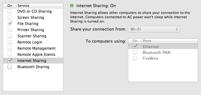

Recently I obtained an iMac G4. It has a 1 GHz CPU, 1.25 GB of RAM, and is running on Mac OSX 10.5.8. I have no options for a hardline and I don't necessarily want to buy a wireless card. In my efforts to get my G4 on the internet, I used an ethernet cord to tether it to my Macbook Pro (Mid-2010). I went into system preferences, then to "sharing."
These are the setting currently set up for the Macbook Pro:
These are the setting currently set up for the iMac G4:
From the settings, it should work. When I open networking on activity monitor on my G4 there is data being received and sent. There are times that my iMac will get on the internet and other times I just get error screens. Is there an extra step that I'm missing? Please help. 😕
From your post it all looks like it is set up correctly (no sharing options needed on the G4 and Internet sharing from WiFi to Ethernet on the Macbook).
The only other thing I can think of is to check your network settings, DHCP, make sure you have no 'hard coded' preset gateway/DNS - all of this should be automatically received from the Macbook. There may be some leftover DNS/Gateway IP's in here which would stop it working, make sure its all DHCP on the G4.
Keep internet sharing off on the G4. Make sure that you have DHCP set for the G4. If the G4 does not get a IP address then try setting a static one in the IP range of your router, but one that isn't being used.
I used to share my PowerBook's connection to my son's iBook G3 when at Starbucks (the antenna is shot) and this is how we did it.
The way I read the original post, I don't think the OP has or is using a router, hence the ethernet connection from computer to computer.
Are you sure that the client G4 is set for DHCP? Check it in the network settings:
system preferences > Network > ethernet

The OP pic of the MBP shows that he is using WiFi for the initial connection on the MBP, so would that also assume that he almost certainly has a WiFi router in the mix?
If the OP has the settings shown, and does not have access to the router to set static IPs, then it would be advisable to have the G4 set for DHCP and the other settings shown kept the same.
