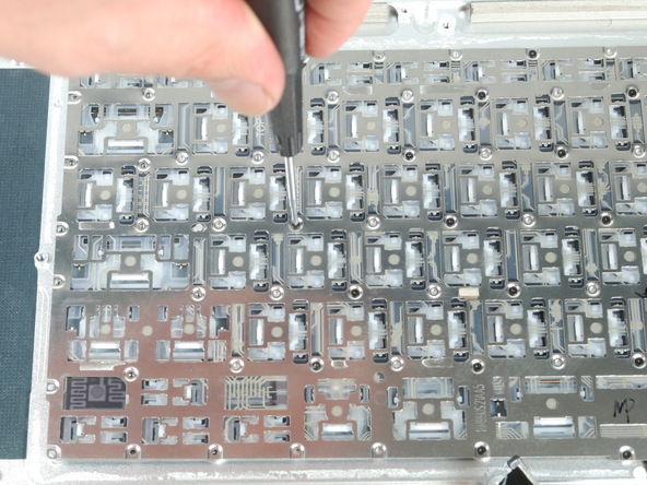

So about a month ago I split water all over my new mbp 13" Retina. Up to now I have, let the water dry from my computer, got it assessed, cleaned entire logic board with 99% isopropyl alcohol, resealed and booted up.
From there I got it all to work except for 2 problems: battery not working properly and NO KEYBOARD!!!
Since then I've reopened it up and disassembled it only to get to the very bottom of the shell before realising I have no idea how to get to the keyboard after removing battery and logicboard etc. Is there any way I can actually clean up the keyboard itself with the alcohol to try to get it working again or is it toast? I don't want to mess around with the battery any more (Got a few sparks removing it!) so I assume I just need to buy a new one, but what can be done for my keyboard? I don't really want to replace both parts if I can help it?
It looks like this from my view:
RRTW3elFmoggPlVq.medium
Thanks in advance!!!

You need to replace the keyboard. ($25 on eBay)
The keyboard is riveted in.
What you need to do (after removing the screws) is turn the laptop over and push down on the keys from the other side.
After you removed the keyboard, use dikes to pull out any remaining rivets.

You can also rip the keyboard right out, but that would leave more rivets that you have to pull out afterward.
