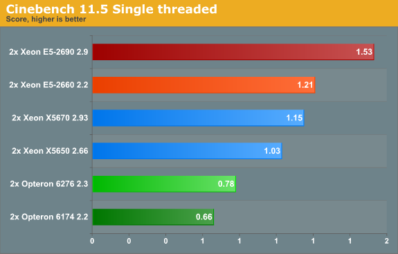

Take a look at the single threaded Cinebench benchmark here.
Source: http://www.anandtech.com/show/5553/the-xeon-e52600-dual-sandybridge-for-servers/10
See the E5 2660 2.2GHz edging out the 2.93 GHz from the previous architecture generation? The multi-threaded result is similar. In the SQL Server benchmarks the 2.2 , for the most part, holds its ground against a previous generation 2.66 (and there are some 6C versus 8C metrics to show the differences).
There are choked software applications. The 3DS Max Architecture 2012 benchmark on the next page the 6C version beats the 8C one. So yeah... turbo does work "in the real world".

Again can go back the graphs in the anandtech article where measure the SQL Server response time. The E5 2660 2.2 turns in better times when there are 8 cores ( which can't clock quite as high) as the more restricted 6C (which can clock a bit higher in some subcontexts.) Cores trump GHz on an extremely wide variety of workloads.
