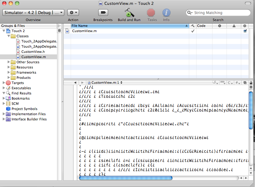

pic
here is the gibberish....

That's an encoding problem for sure.
Skipping the inverted question marks, what's left looks like normal text. This suggests the inverted question marks are 0x00 bytes, which would be the high byte of a Unicode UTF-16-BE or UTF-16-LE encoding. The two other characters before the first / are probably the byte-order mark (BOM).
So somewhere or other, Xcode was probably told to use UTF-16.
Got it... FIXED
Thanks All, you guys were all over this!
The fix was Xcode/preferences/Text Editing/Default File Encoding:
was set to UTF - 16 I just set it to UTF -8 and BANG! was fixed.
