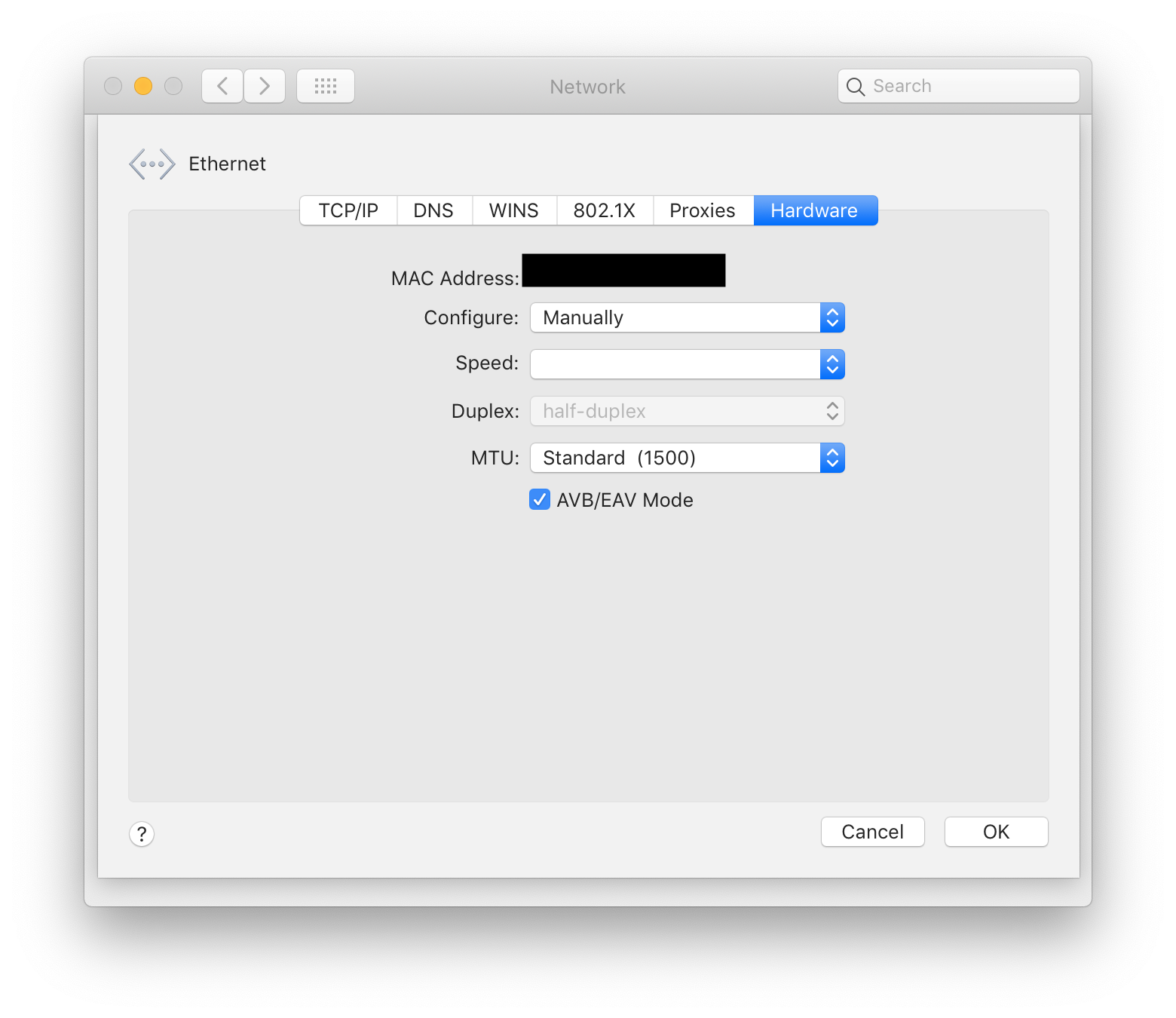

There's an option to configure the Ethernet Port manually or automatically.
You can select 10BaseT,100BaseTX or 1000BaseT. Gigabit is the last option. I take it that you're plugging the same cable into the thunderbolt adapter?

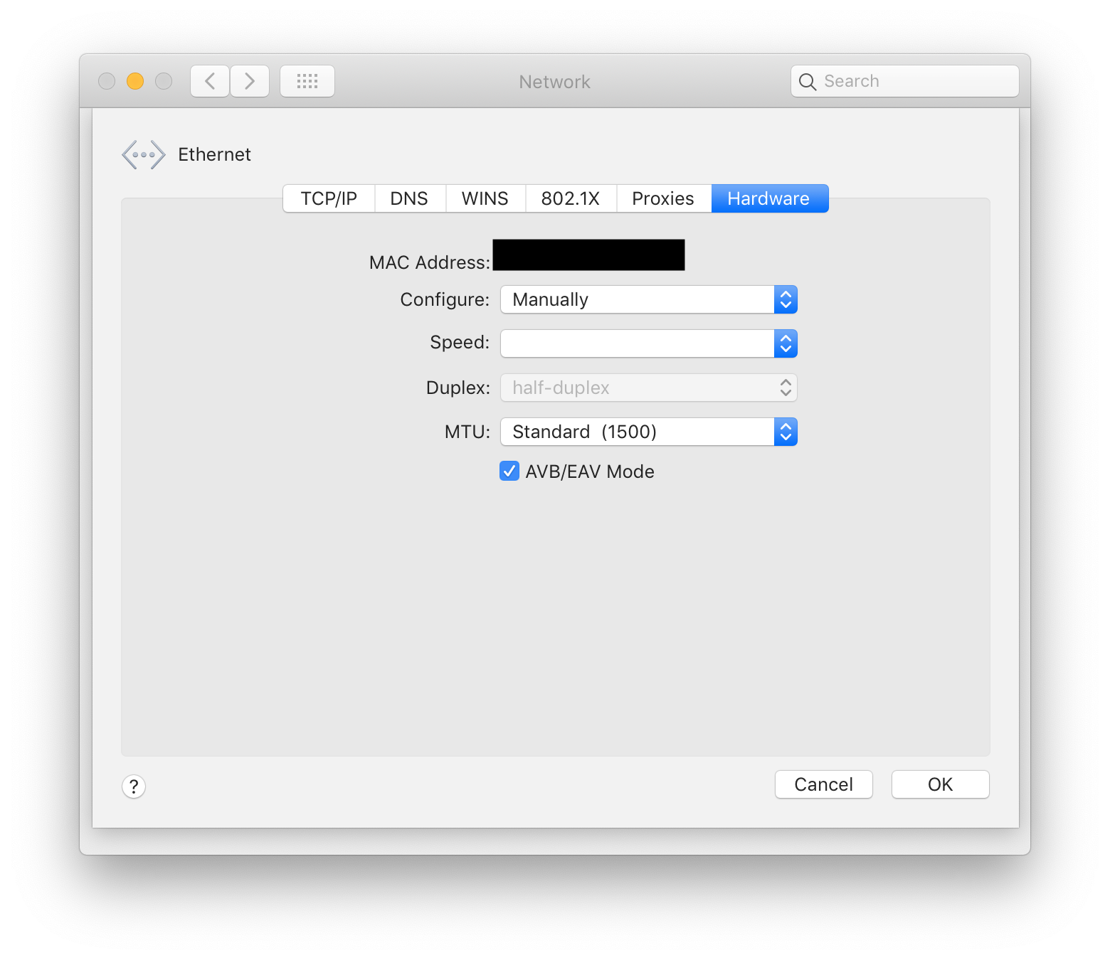

I forgot to mention I tried to set it manually but it just disconnects.

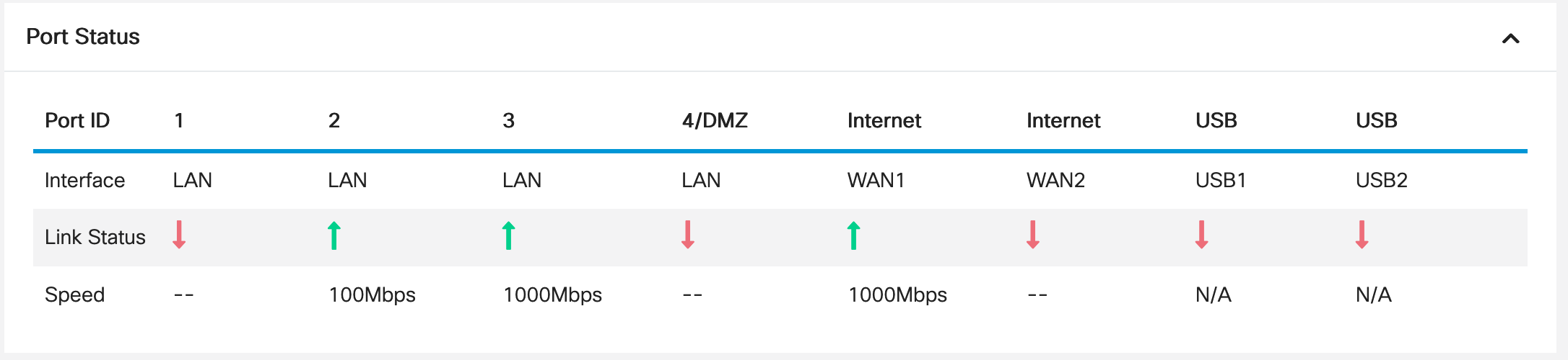

My Cisco router did exactly the same thing. The router port status table showed that the port was 100 Mbps rather than 1000 Mbps. It is then an open question as to whether it is a Mac issue or a Cisco issue. Since Cisco support created a feature request and didn't point their finger at Apple I assume that they felt that it was their problem.

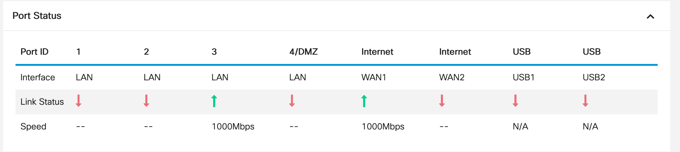

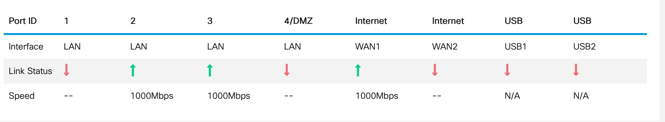

To illustrate I moved my iMac Pro ethernet cable from the 10 Gb QNAP switch to the Cisco port 2. You can see it shows as 100 Mbps. Note that the RV340 only supports 1 Gb.
