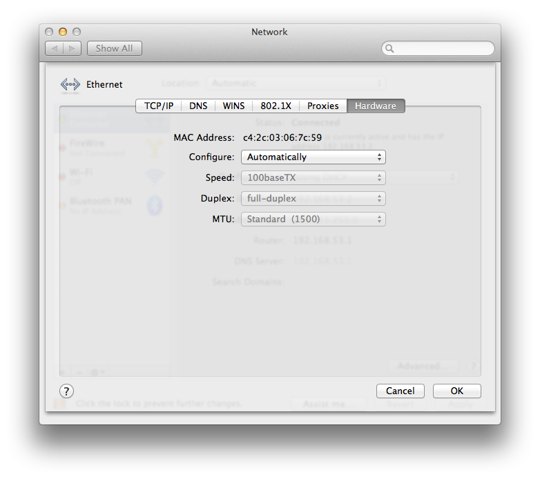

It's possible to software restrict the ethernet port on a Mac. In system preferences, check to make sure it's set to automatic (see attachment).
If it's not a software issue, describe your network setup a bit better. What is plugged in to the switch and what is plugged in to the router.
Also, if you have a port on the switch with a cable that you know is working at gigabit speed, plug that cable and port in to the iMac.

Thanks Bear, I very much have explored the options you suggested. I have tried a Cat5E cable, a Cat6 cable, and then re-tipped the Cat6 to be a crossover cable just to make sure that wasn't the case. It isn't the cables. When I override the connection and set it at gigabit I get the "Ethernet cable is unplugged" response from the Network prefs. I have tried jumbo frames and all combinations of settings. It isn't the software either.
