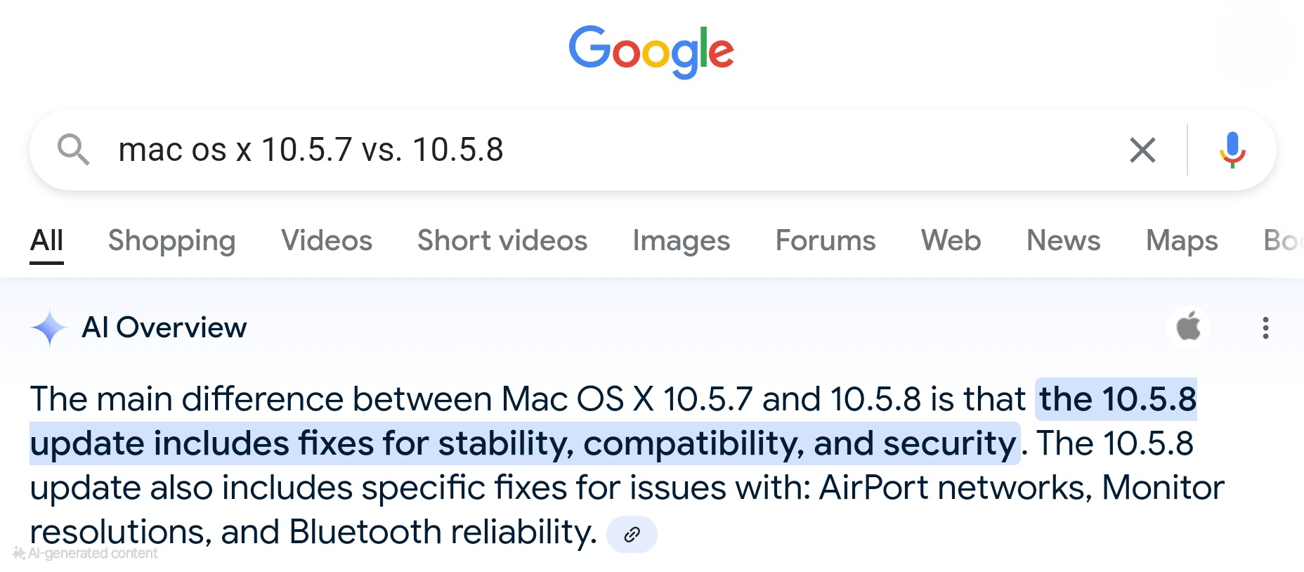

In fairness, the only difference between 10.5.x and 10.5.x-1 is tweaks. For example, for the difference between 10.5.7 and 10.5.8, I got:
just tweaks and fixes, just like Sorbet.
... so, while unofficial, it seems reasonable to bump Sorbet to 10.5.9, which is in fact how is presents itself in "About This Mac".
