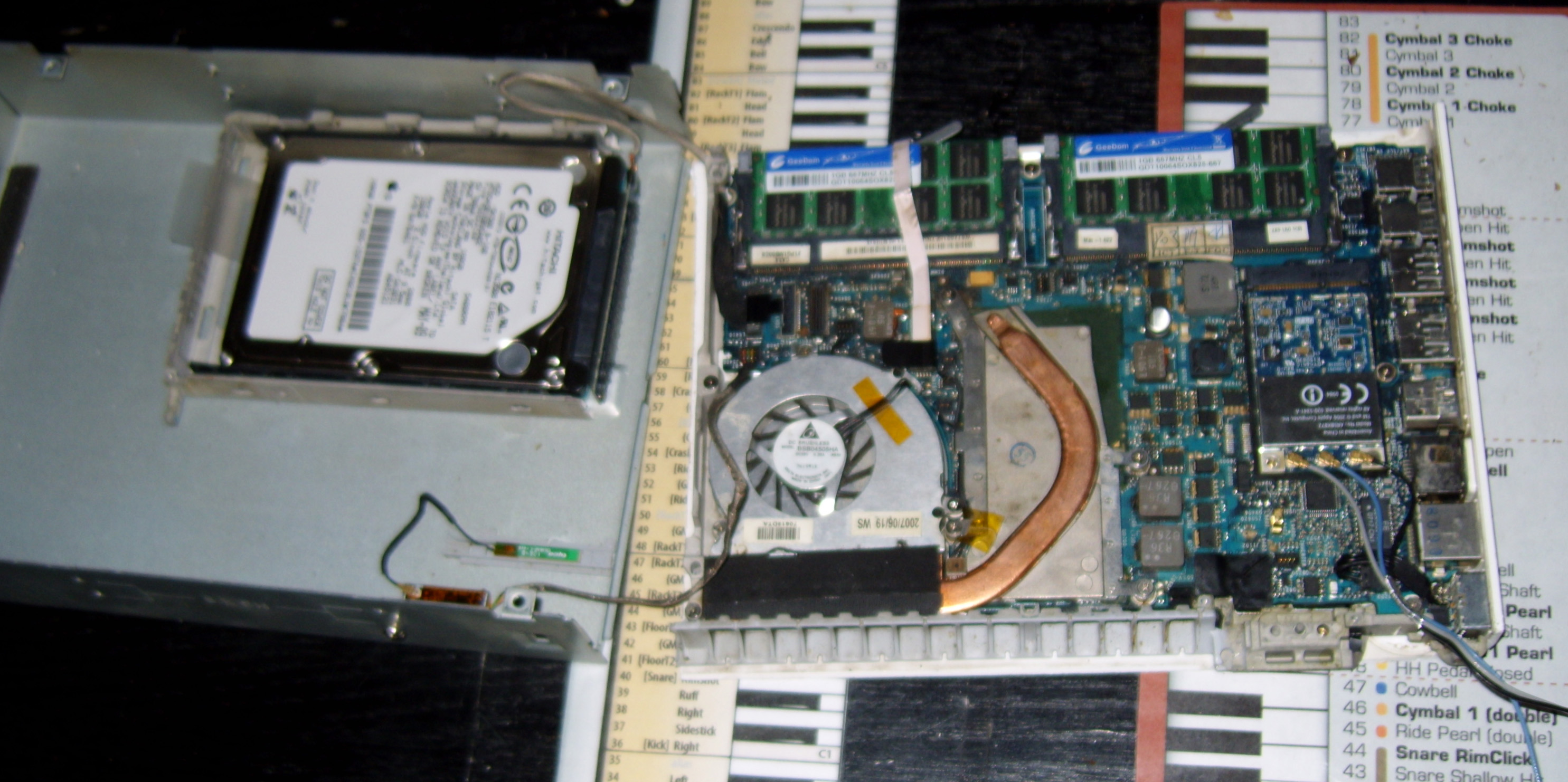

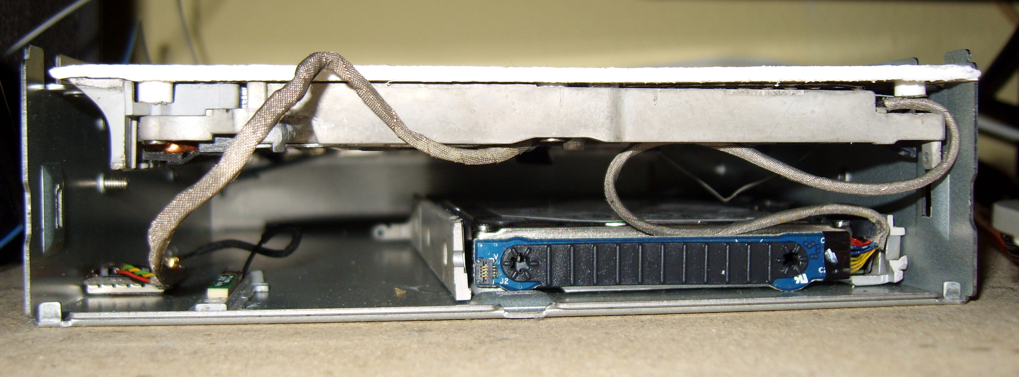

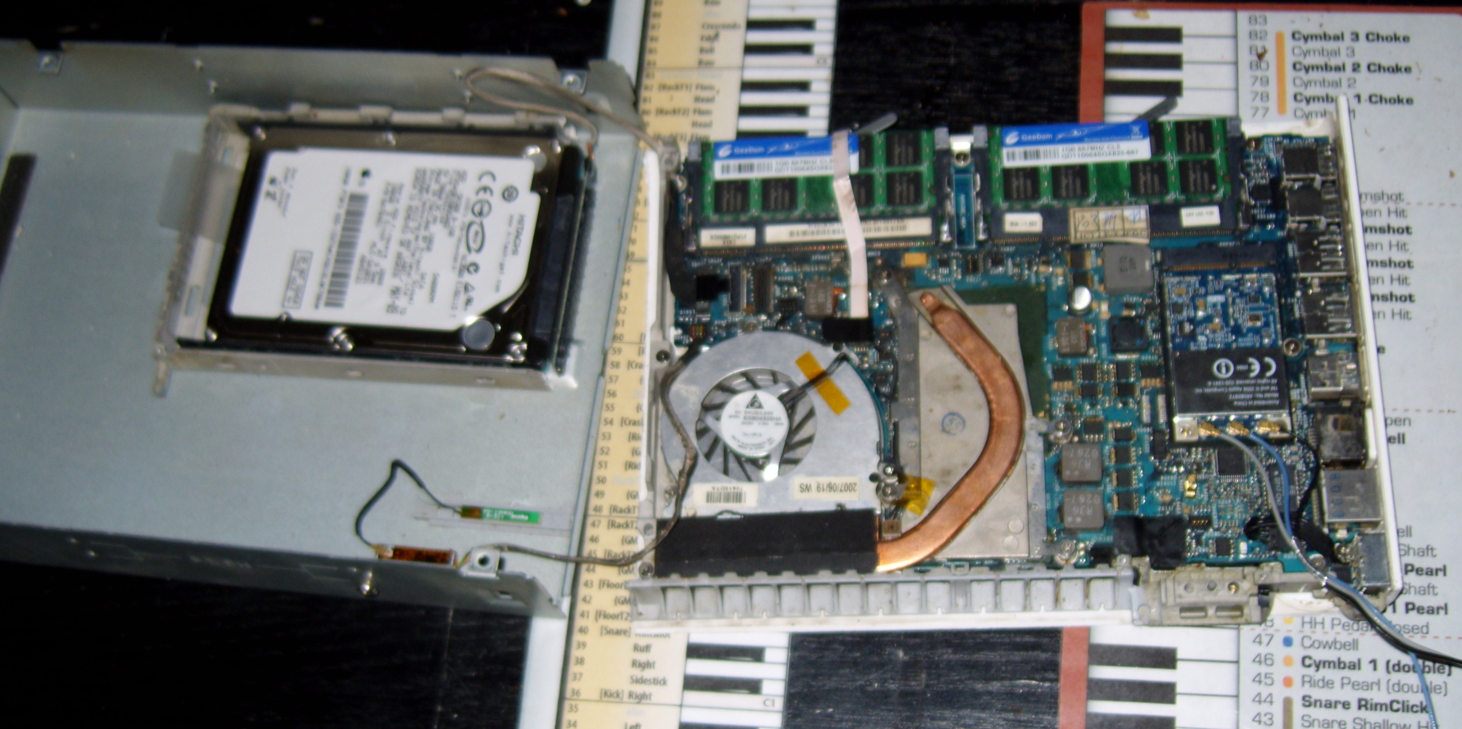

Pics
Here a few pics.
the holes for the cooling are not drilled into the case at this moment...
sounds to me like the fan speed controller on the motherboard... or even the software that regulates it is malfunctioning. Since you're into modding, I would just suggest a different heatsink and fan if that one is too loud.
What heatsink and cooler would you recomend?
