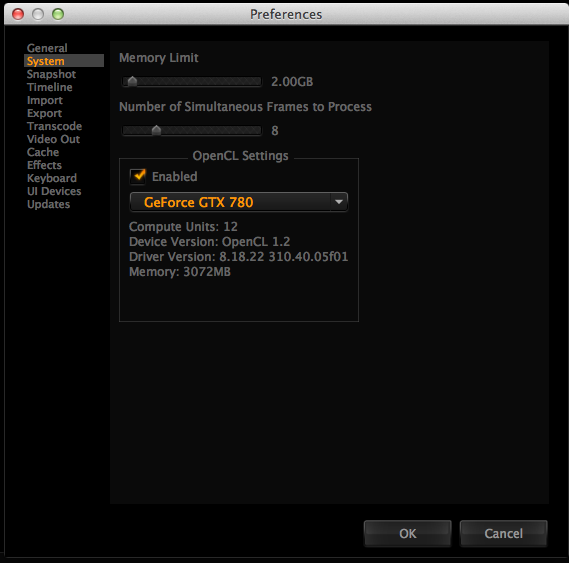

I don't know enough to actually use the program but I was able to open up and find that System panel.
Shows a regular 780 getting there just fine.
I will be offering to temporarily trade him so that I can have a "b" card for further testing.
Anyhow, anyone getting a PC Titan or 780 that shows as "b" in ROM or GPU-Z is welcome to see if their OpenCl is working in 10.9 and post here.

I can confirm that my 780SC rev.B will not support OpenCL throughout the OS/Program. It crashes instantly when trying to access any use of OpenCL.
