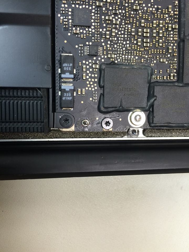

So I got a late MBP 15' 2011. Since day one ive had issues with it, I got my logicboard changed twice and now looking for a third change.
I paid for the first one because my MBP was out of warrenty fair enough.
So I got it repaired and then three weeks later it had to be changed again and I did not have to pay because of the 90 days warrenty.
So what happened this time was I was playing on my MPB and then all of the sudden the screen went sideways and i had lines on my screen. So I figured after doing research that it was my GFX card that went out, and it also got confirmed by two apple tech guys.

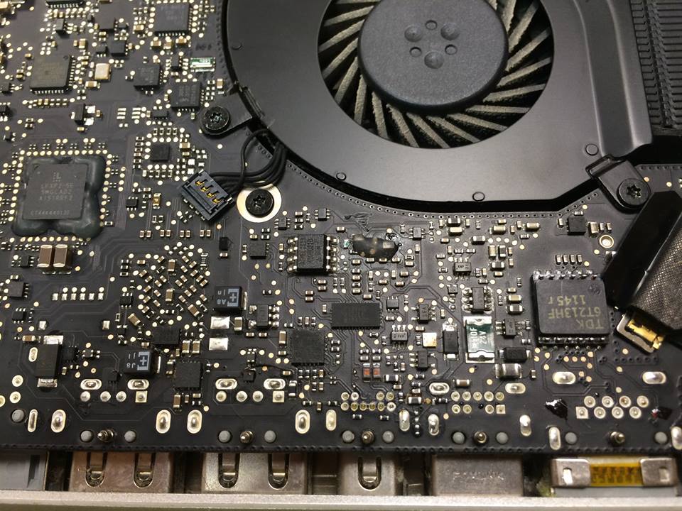

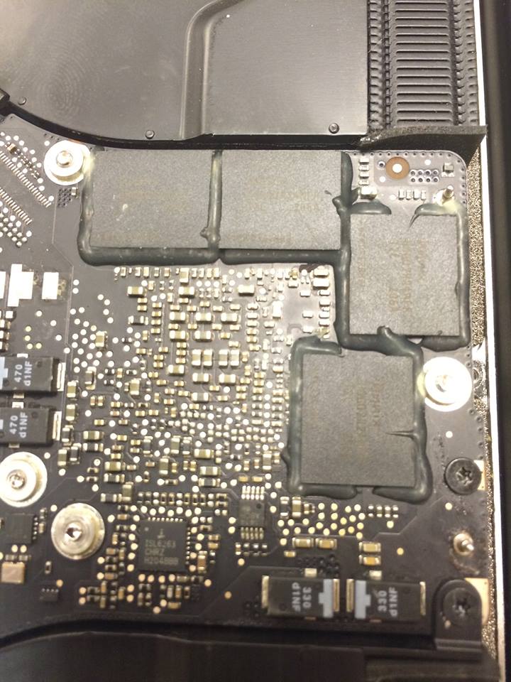

Now while opening it up I had weird glue pieces on my logic board, several places and the lead genius could not give me a clear answer. so after debating with them trying to get them to tell me what the glue was they escortet me out of the apple store. Afterwards I called costumer relation and told them what happened and how rude they were in there. In my defense the only thing i kept saying was that the solution of paying $300 for another logic board repair was not going to work for me. I kept asking them what kind of repair they had to do in order for my computer to work and they said logic board, but because my previous repairs was unrelated.
Now my question is have anyone ever seen glue like this on a logic board ( I will post pictures. ) If no or yes what is your thoughts on what it is ? thermal paste?
I really hope you guys are whilling to answer my questions.
That's BGA adhesive or underfill. It's used to strenghten the solder joints of BGA chips. There's a bit more of the stuff than usually, but I'd be more worried if there was none.
What I find more unusual, are what seem to be traces of flux around the grounding pin. Maybe someone with more experience with refurbished logic boards can tell you, if that's common or not.

A more permanent fix is to get a re-ball. This is where they remove the chip and replace the solder beads with new ones. Apple does not do this. You need a 3-rd party service to do it, but it would last much longer.
I've to disagree with you.
That logic board was one of the Radeongate boards. Even a lead solder reball doesn't guarantee a permanent fix.

Just to make sure so you guys say its an adhersive ? does it mean that it is glue that is holding the chips ? or is it cooling paste.
The lead techn genius at the apple store told costumer relation that it is cooling paste.
Answered your own question right there. It is a bit of both - and it serves a very important set of purposes for the chips and logic board. BGA adhesive/underfill makes the connection between the chips and the logic board more robust and can help mediate temperature gradients between the chip and board.

OK, first things first, I'm guessing by your first post that you were aggressive (or demanding) with the guys in the Apple store - that will get you nowhere with them. Treat them nicely, and you'll generally get more help from them.
That is a very poorly refurbished board 🙁.
Question: How long ago was the previous repair? If it was less than a year or so you may have a case. If it was back in 2012/13, you may struggle.

I think, they got you out of the Apple Store because they knew it.
They knew, you got not a new logic board, but a kind of emergency repaired one. To me it looks like your board had been major stripped from bad chips and then balled it back with new chips. The repair tech used a bit too much of the glue. Thats not a bad thing, however it shows you, that you did not get a new replacement logic board from the factory one, but a reballed one.
I would demand a real replacement, not a recalled / recalled one. Especially if the one in question acts weird.
