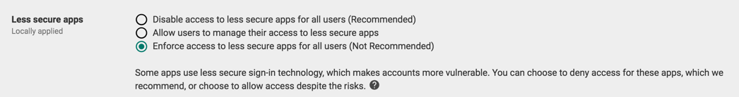

I had to select the following for it to work (I had Allow users to manage their access previously but didn't work):
I am not using 2-step verification.
This solved the issue for me.
Thanks!
