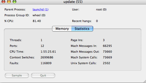

ok, here are some pictures of whats happening. when woke up this morning the fans were on full - and these showed up..

In comparison to mine, the only numbers that seem out in the right-hand grab are the total CPU time (obviously) and the number of context switches. Yours # of context switches is huge compared to mine, but all the other numbers are actually similar in magnitude....
I have:
Threads: 1
Ports: 14
CPU T: 52.61 (slightly less than a day of uptime since getting 10.4.1 on yesterday)
Context switches: 27k
Faults: 81k
Page ins: 3
Match in: 57k
Match out: 61k
Match calls: 61k
Unix calls: 1400
