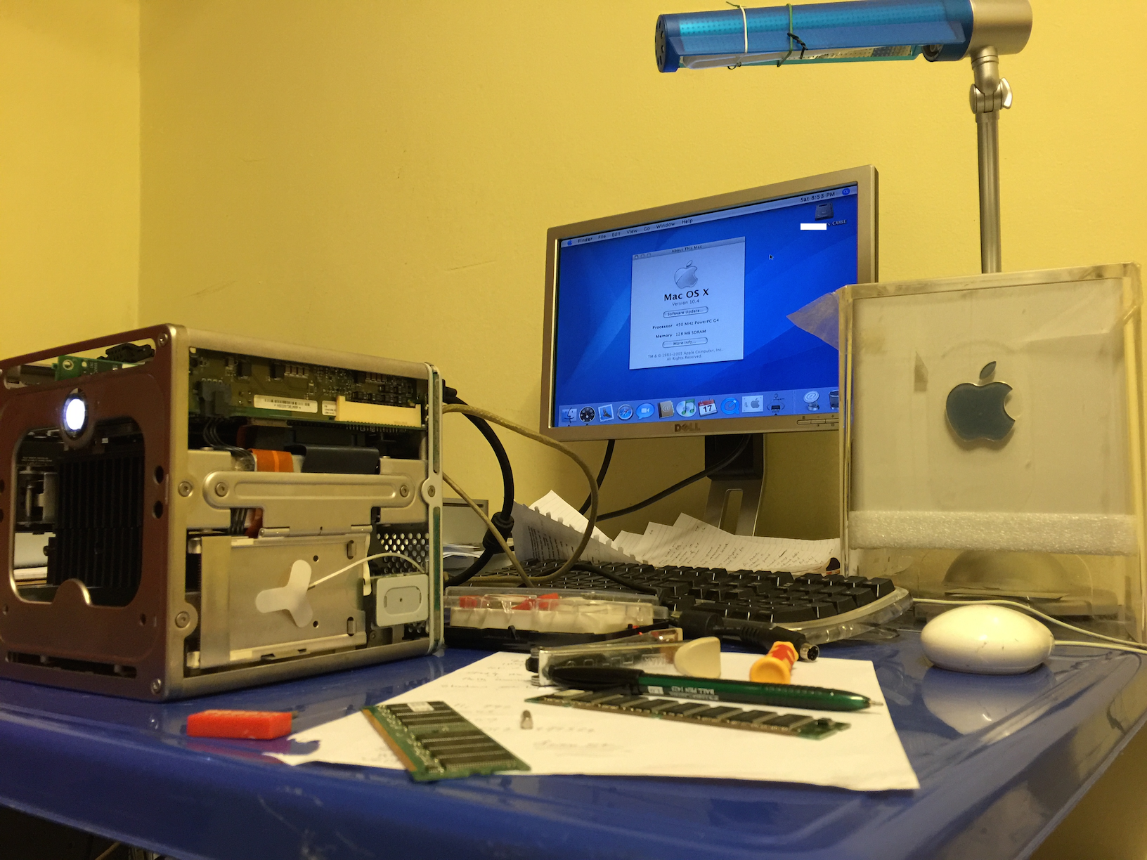

K guys, been more than a year, finally found some time to meddle...
...cloned 10.4, inserted the hdd, switched on, phew, some progress than before, but still ddnt boot, it was the rider logo with the "?".
tried booting externally from the Cube, still same, this really boggled me, as the the instead hdd did boot externally in a mac mini. Reset pram still same...

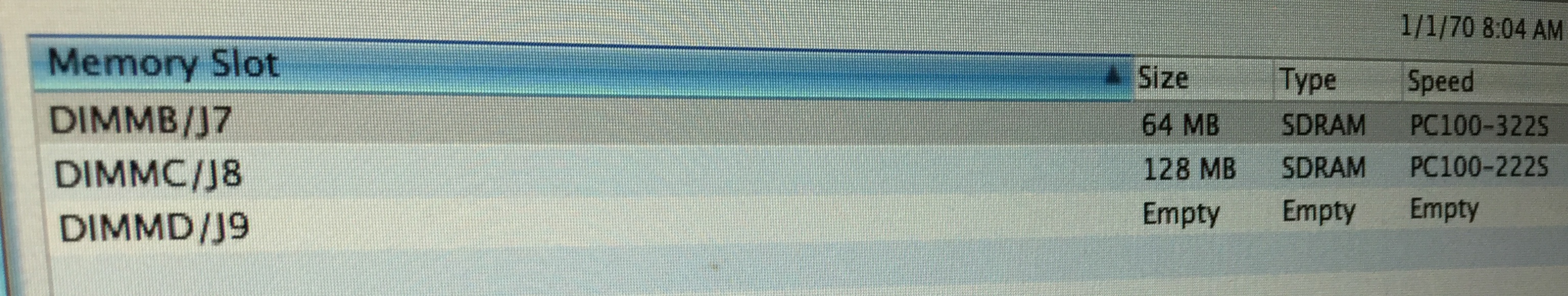

Took out the rams and tried with a single stick (had three in it).... Thank Jesus, the CUBE booted...YAHOOO!
i think it was the rams issue, apart from the earlier HDD issue..
slotted in all three sticks, but still one of it is not recognised

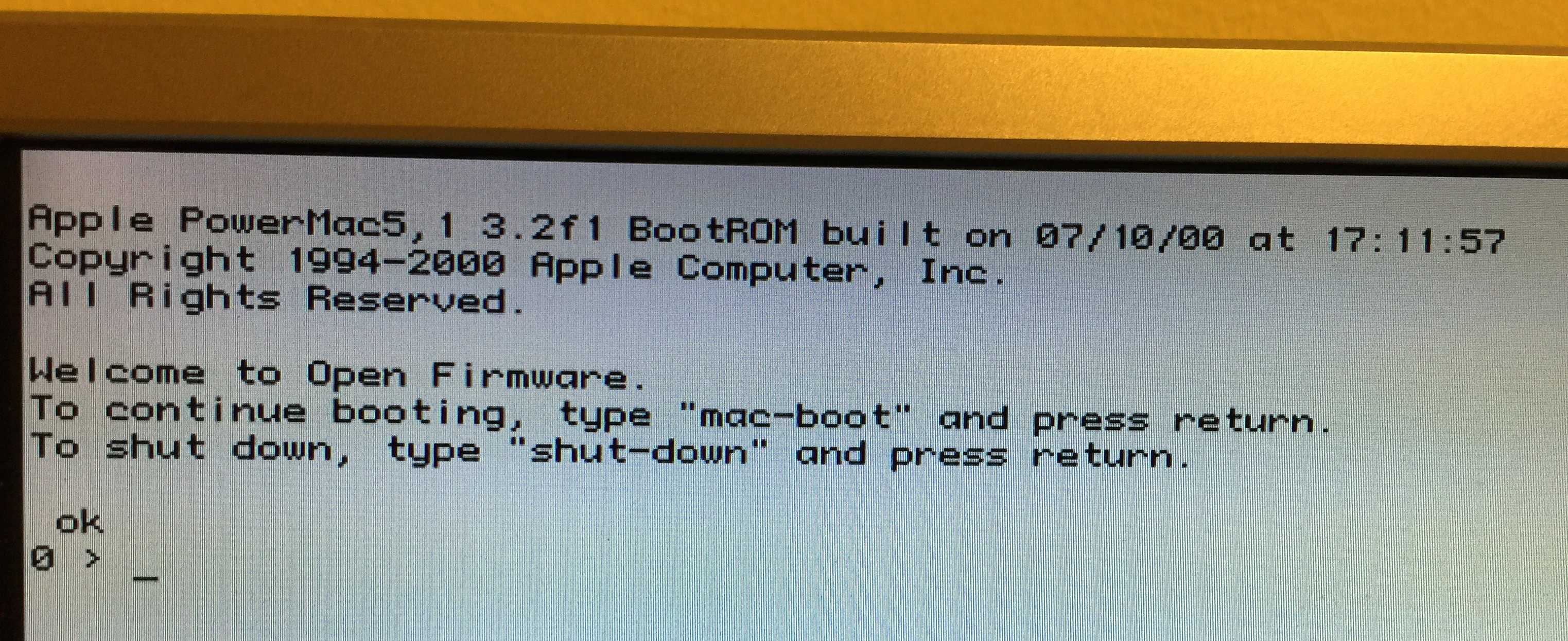

Are you able to get it into OpenFirmware? Also I'd try reseating the RAM or putting in RAM of yours that know works, and try reseating the video card as someone else already said. Nice Cube though, even if it doesn't fully post.

I just need to replace one of the rams or one of the slot has an issue or needs an air gun!

The RAM ought to be easy enough to replace if that's the only issue.

Yeah, the ram or the slot needs some brushing.
