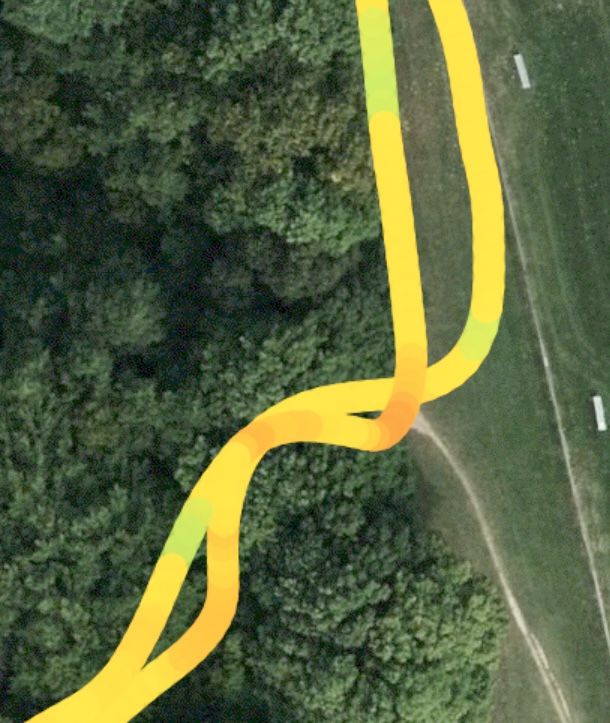

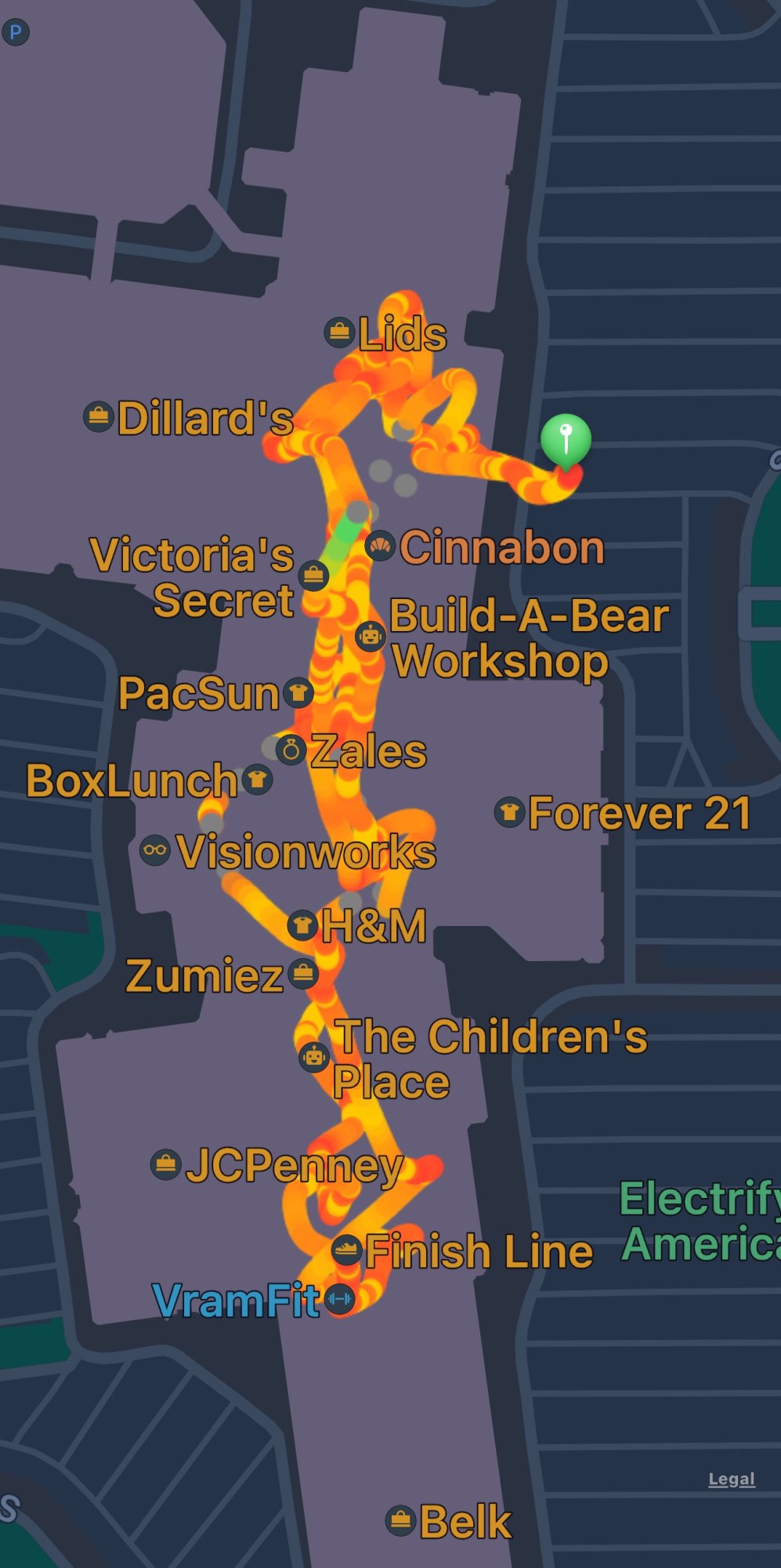

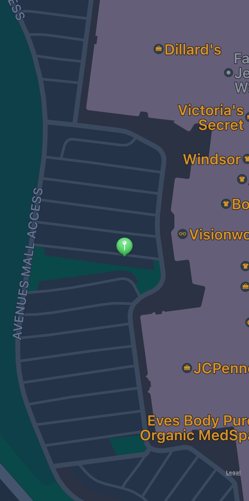

i am not finding tracking to be dependable.
‘’’Most the time, tracking works perfectly but sometimes is fails!
Normally my tracking looks like this:
when it fails it looks like this:
‘It fails about half the time. I hit the crown and pick outdoor walk, wait till the circle in the top left corner turns blue and chimes and then hit the action button. What am I doing wrong?

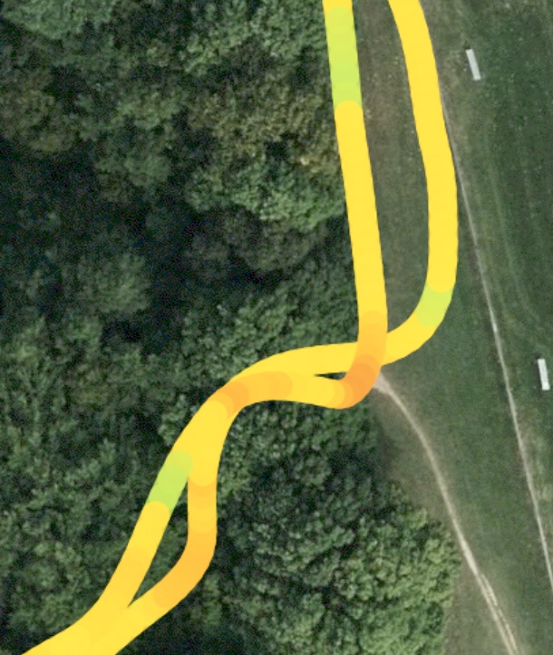

The GPS has been great in my experience. Detects correctly what side of the street I’m on in urban areas and on my hike yesterday when exiting tree cover to open ground it didn’t appear to have to do any correction.
