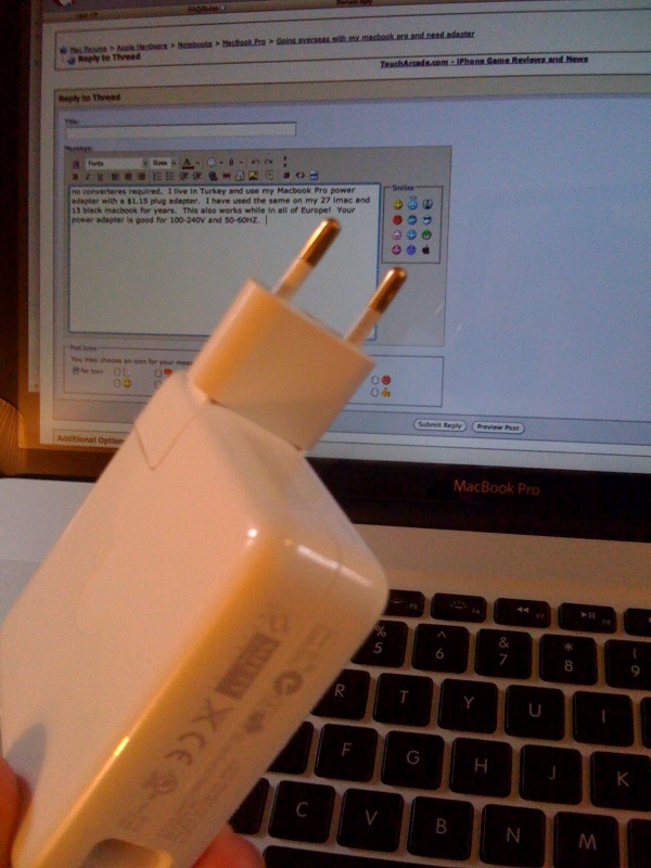

no converteres required. I live in Turkey and use my Macbook Pro power adapter with a $1.15 plug adapter. I have used the same on my 27 imac and 13 black macbook for years. We have the same power here and my adapters works while in all of Europe, i was just in Germany last week and was in Italy before that! Your mac power adapter is good for 100-240V and 50-60HZ. This will be the same with most all video cameras and digital cameras as well just look on your charger for the 100-240 50-60hz and plug that bad boy in🙂
I attached a picture of my adapter!
Also, if you are leaving in more than 2 weeks you can send me your address to rmitchell248 @ yahoo . com and I will even put one in the mail to your house for you no cost I can buy them here for a about 1.15 USD like I said and would be more than happy to send one your way🙂

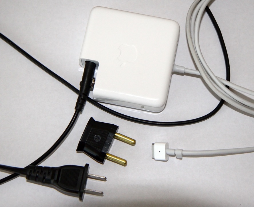

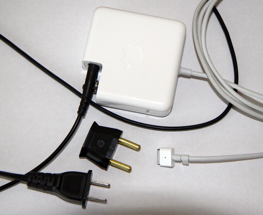

Attached picture shows my arrangement for travel and home, because it gives me more length / room to maneuver.
Cheap and practical and no voltage converters needed.
