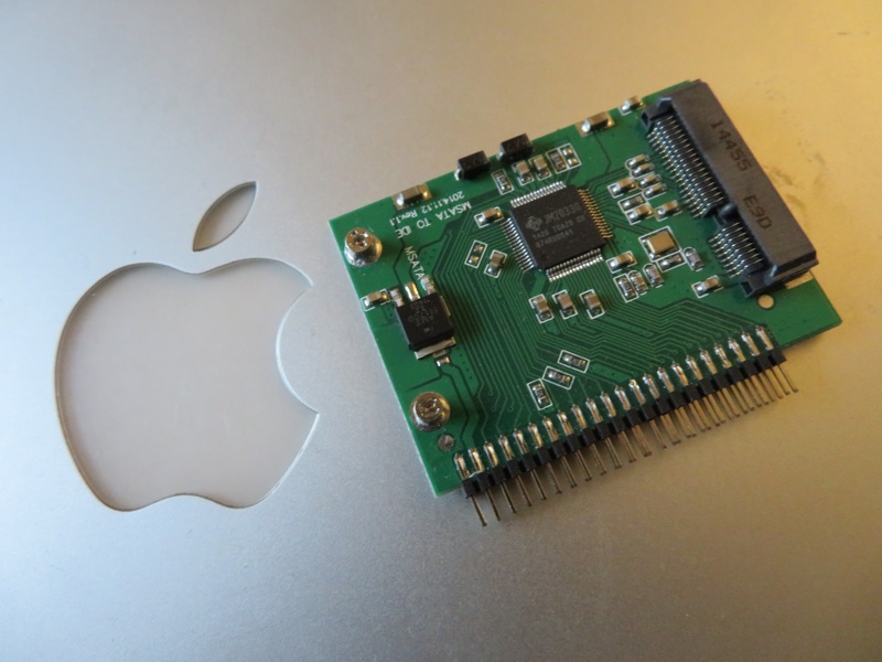

The HDD is going in my Power G4 DLSD/HR 15 inch. I know the right adapter to buy, and I will buy either a 250 GB or 500GB mSATA, most likely a Samsung. What are the issues, if any, that I may face once I install the new drive?

As far as I'm aware, as long as the adapter is correct, none. When I installed mine, it was as simple as plug it in and install the OS.
I did a CCC block level clone to a DMG via TDM to my Quad.
Once I had the adapter and drive in, I put the PB in TDM again and used CCC again to block level clone back to the mSATA.
I had zero issues. Mac booted right up like normal.

Once you install the drive the only issue you should face is not ever being able to stand using a PB with a spinning drive ever again!
I have two 15in Alu G4s, I fitted an SSD to the first one years ago, a Samsung **IDE** SSD (that long ago!) and it was the best thing I ever did to the PB, recently it started having DC board issues so I bought another one to tide me over while I find a DC board and fix it, and having to go back to one with a 5400rpm drive is torture by comparison.
So I've bought an mSATA card and an IDE to M2 adapter to convert this one too ;-)
