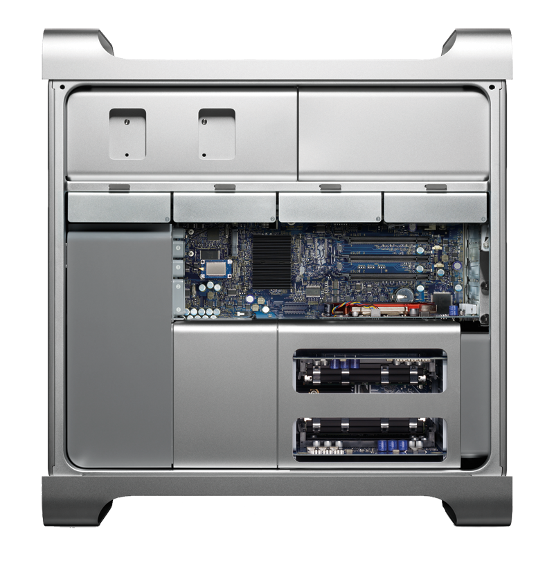

sorry forgot to meantion that. stick it in the third slot if you have a single lane graphics card or in the fourth slot if a double lane graphics card (leave a space between graphics card and Firewire card for air flow). if you only have one slot left then thats fine.

the ATI is on the bottom slot out of the box right?
sorry i forgot the first slot is double laned allowing double slot cards to be put in. put it in the second slot so there will then be a gap between both cards and a metal slot gate between them at the back like this.
