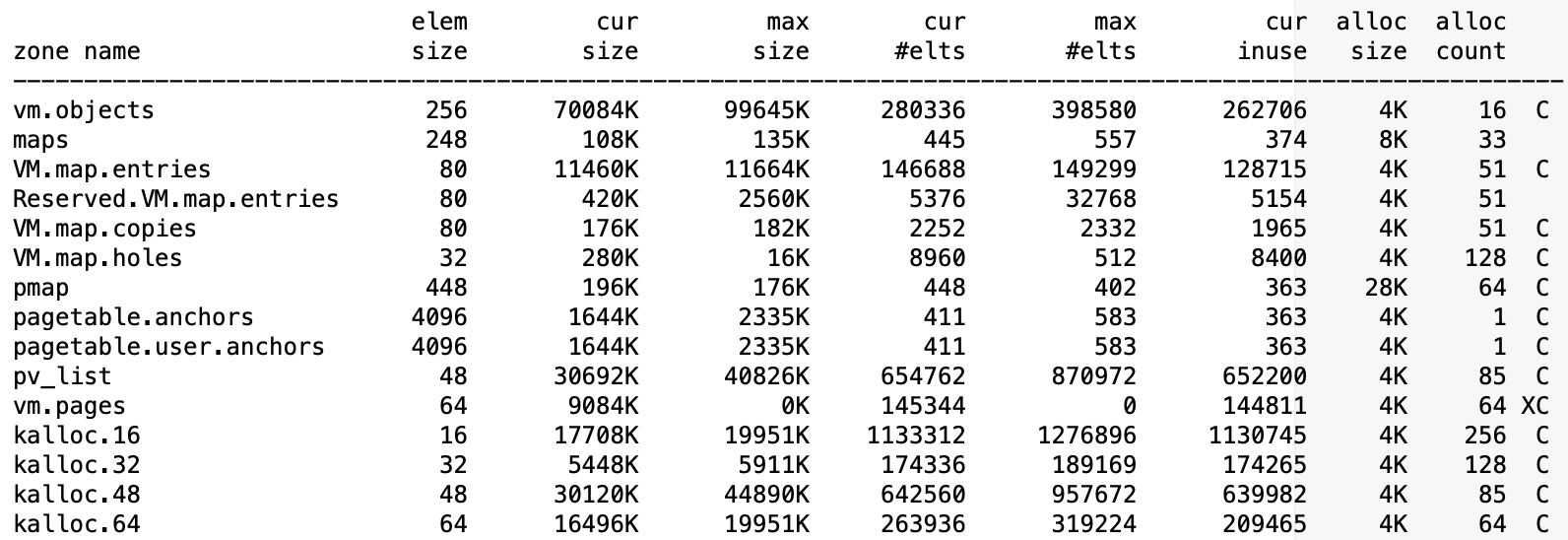

Thanks, with that search term I was able to find this article by Howard Oakley, which makes it more concrete for me:
Oakley mentions if you have a kernel panic you can check your logs for a "kernel zone_map_exhaustion" message. But what about more routine wonky behavior, which doesn't involve a kernel panic? If it's indeed due to insufficient zone memory, would that also show up as a "kernel zone_map_exhaustion" message?
I'm specifically wondering if the routine, and less catstrophic, wonky behavior I typically see with extended uptime could be due to 3rd-party apps running out of zone memory instead of the OS, and whether that would generate a different message. Alternately, since even app zone memory is alloacated by the OS, would zone memory insufficiency, regardless of whether it's memory for an app or memory for the OS, always generate a "kernel zone_map_exhaustion" message?
Oakley also writes:
"You can inspect the kalloc.n zones with the command sudo zprint kalloc which should make it clear which are growing to a dangerous size. zprint also supports options which allow you to monitor changing allocations, which could help."
There is this option:
-s zprint sorts the zones, showing the zone wasting the most memory first.
But I'm not sure what that means. I would think it would be more interesting to sort them by the zone that is closest to its maximum, and/or approaching its maximum most quickly.
It would be cool if there were some third-party utility that could monitor and summarize this for us—maybe something akin to Activity Monitor's "memory pressure" indicator, except instead displaying a graphic that communicates when the "zone memory pressure" is getting excessive for any zone.
I'm specifically wondering if the routine, and less catstrophic, wonky behavior I typically see could be due to 3rd-party apps running out of zone memory instead of the OS, and whether that would generate a different message. Alternately, since even app zone memory is alloacated by the OS, would zone memory insufficiency, regardless of whether it's memory for an app or memory for the OS, always generate a "kernel zone_map_exhaustion" message?
App bugs, 3rd-party or otherwise, can not cause zone alloc failures. That is exclusively a kernel issue, as only the kernel (and kernel extensions) can kalloc(). Of course, apps (even without bugs) can trigger kernel bugs that leak memory, eventually leading to zone failures.
Your questions show that you don't know enough about kernel isolation from user processes to have a good conversation about this yet. And I'm sorry I can't give you good pointers to resources on the topic. I will note that it's likely that high-quality info on Linux or other unixlikes is likely to carry over to MacOS in general outlines, if not in specifics. So there is quite a lot of material out there.
The answer to your last question, however, is a straight "no". There are many types of resource exhaustion, as I have tried to say a couple of times now. The followup question is likely to be "well, what kinds of log messages will I see then?", and the answer is, "A whole bunch of different possibilities". There is nothing simple, no short list of errors, that I can point you to and say "look for this".
EDIT to add: You haven't shown evidence that you're actually having a kernel issue. There are other components, as I've previously mentioned, that are not part of the kernel, that can cause all sorts of wierdness. Windowserver and Dock.app come immediately to mind, but there are more.
