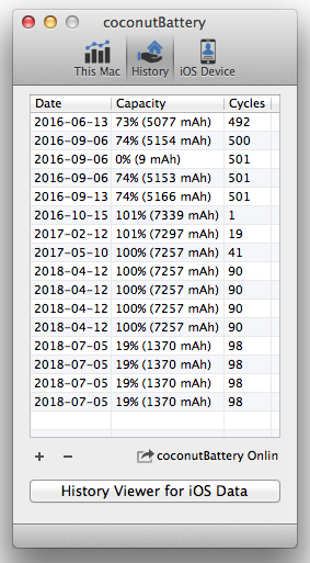

It also looks to me like the NewerTech battery reported incorrect capacity data, until the failure just became too obvious:
