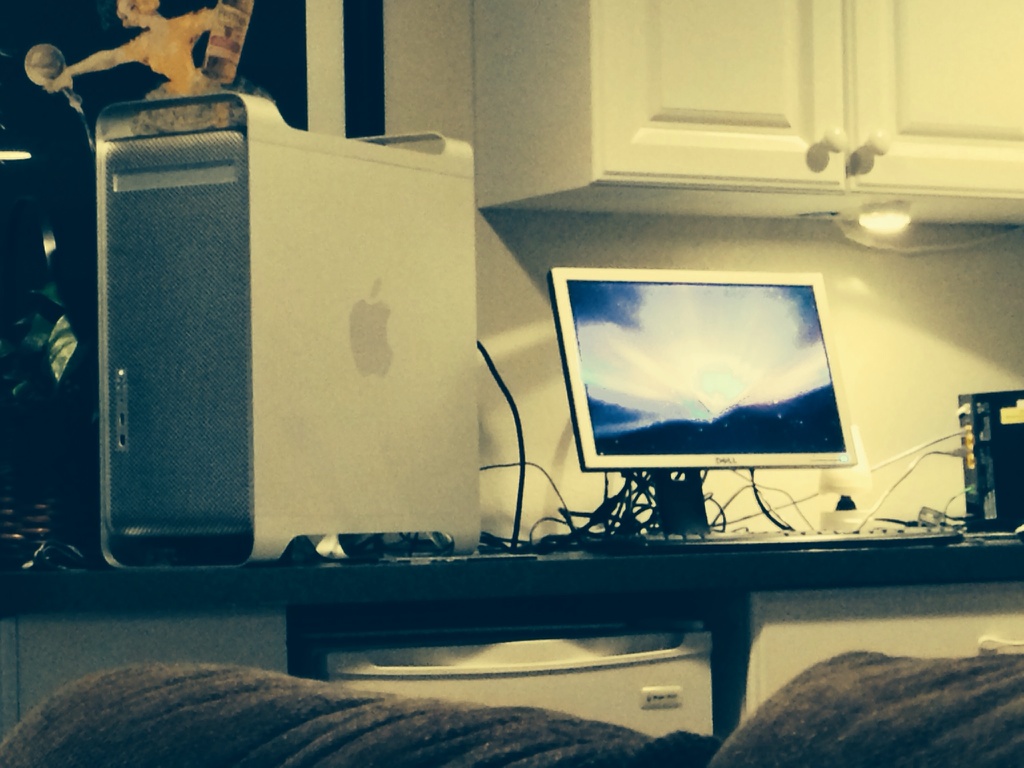

Finally found some time to get the Mac to the basement to hook up to the router. It's now updated to 10.5.8 and iLife 09' is now installed. Any programs I should get before I disconnect from the internet? Already have TenFoxFour and VLC Player. Also have a PowerPC version of Minecraft!
Just ordered an AirPort Extreme card! This has been needed for a long time. Without it connected to the internet I don't use it too much.
