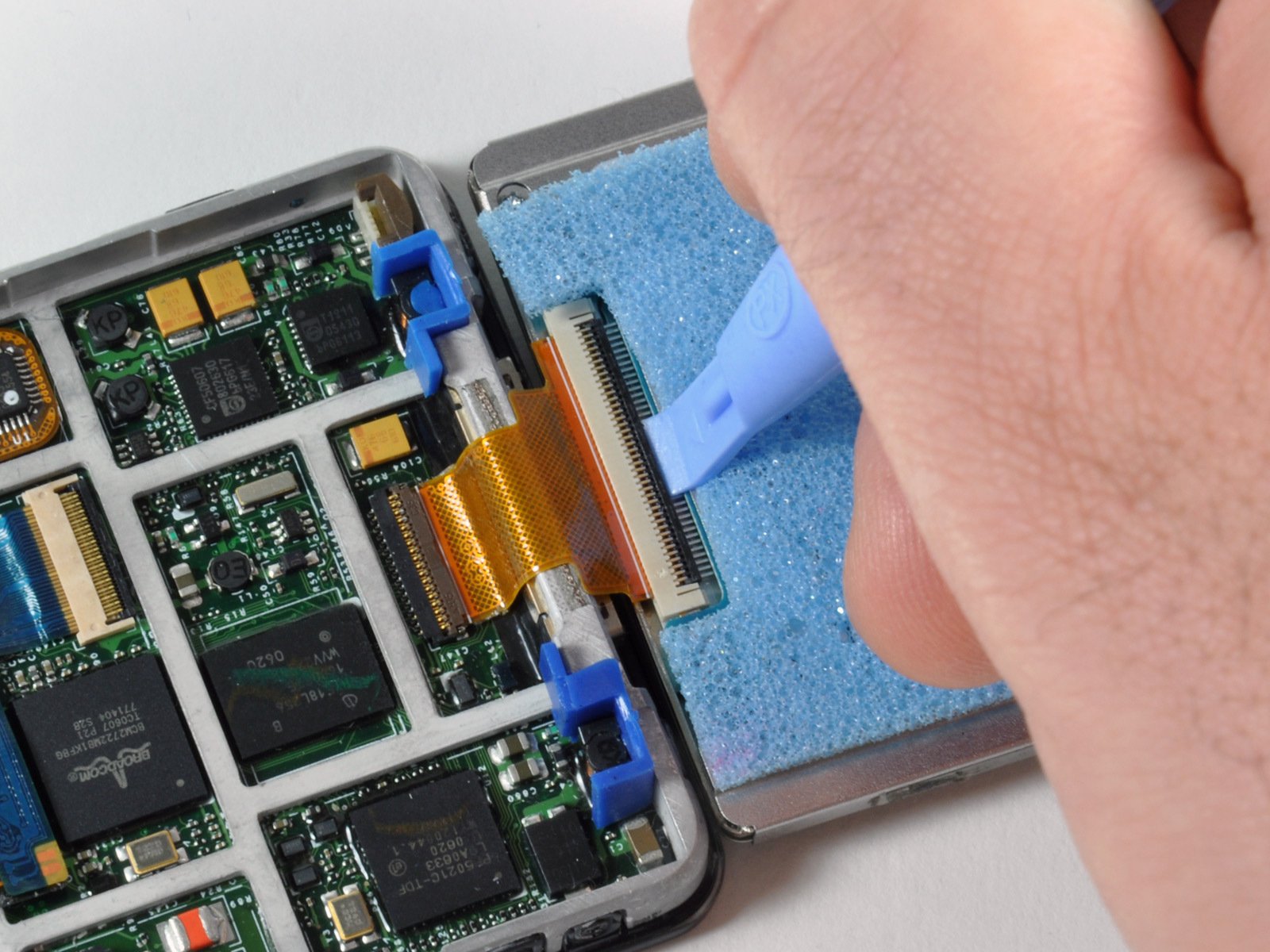

You should be able to replace the HDD though. Maybe even take advantage and use this time to swap in an SSD. I'm not sure how it works with the 5th gen, assume its the same procedure as other models.
It is, sort of. I don't have a 5th gen, but I do have a flash-modded 1st gen Mini so I'm vaguely familiar with the process.
@jouster My condolences, I have a 6.5 gen I got new and I will be very sad when/if that goes. The RockBox wiki has some good information if you're interested in a procedure like what we're talking about: https://www.rockbox.org/wiki/CFModGuide

I'd concur to convert the iPod to flash memory. Just don't go crazy with the size as it will struggle synching with iTunes.
It's understandable if you don't want to do it. Consider putting it on ebay as broken. There's a market out there for people that convert them.
I think 256 would be perfect, my 6th gen is limited to 128 and while its fine I like the extra space of my 160, I just won't take the 160 out of my house. My 128 lives inside my jeep.
