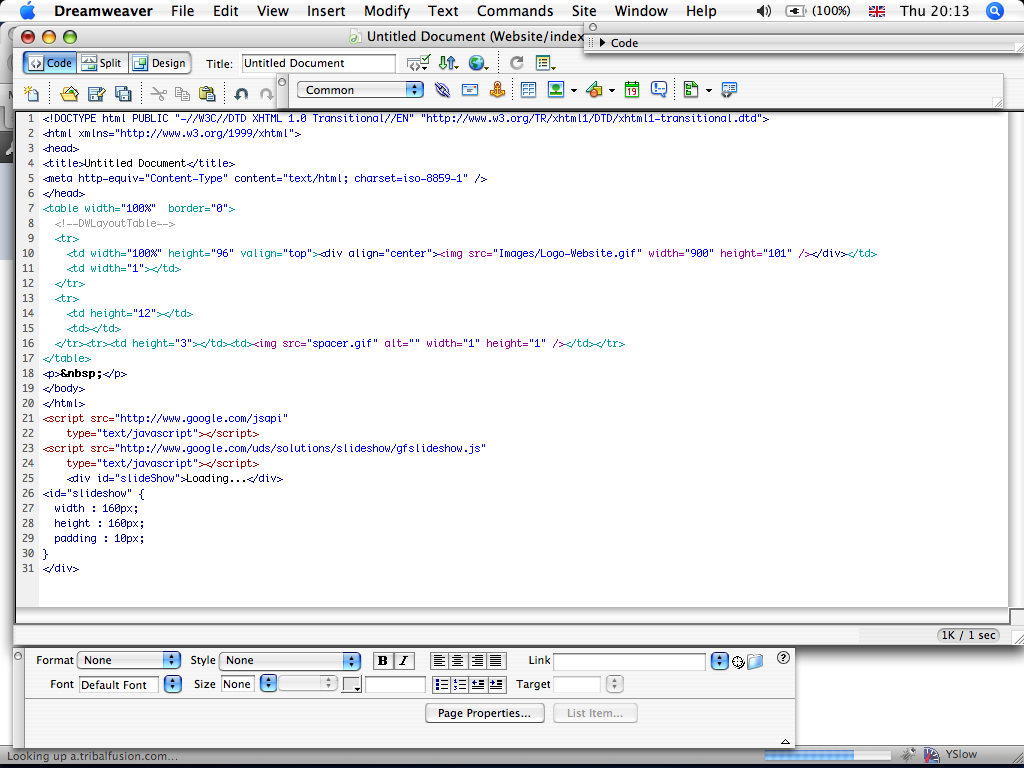

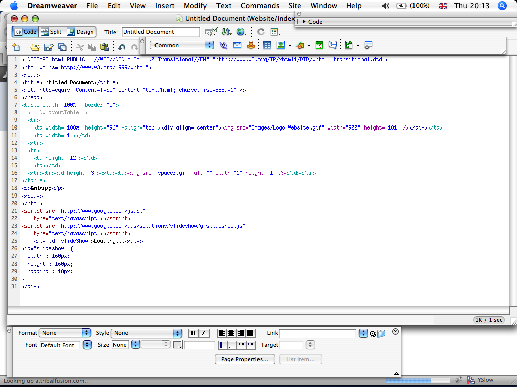

I am having trouble at the basic stage of entering the code to load the google ajax feed (slideshow). I have attached the code. Any help is much appreciated.
A couple things, the biggest being I see no starting body tag (it should be right after the closing head tag). Secondly, even when you see others do it, don't place any code after the closing html tag at the bottom. It's very invalid code.
Thanks angelwatt, what is a starting body tag? I know very little about code. Sorry for silly questions.
Can anyone show me how to write this properly? I don't understand what is wrong?

That CSS needs to be inside a style tag, which is in the head tag. Also, the id attribute should always be unique, you currently have two div tags that have the same id name.
