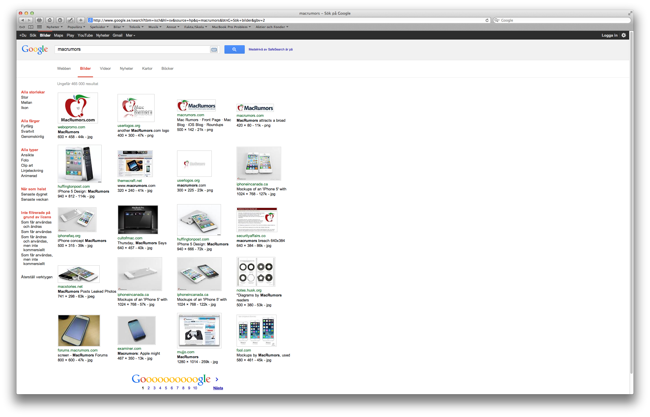

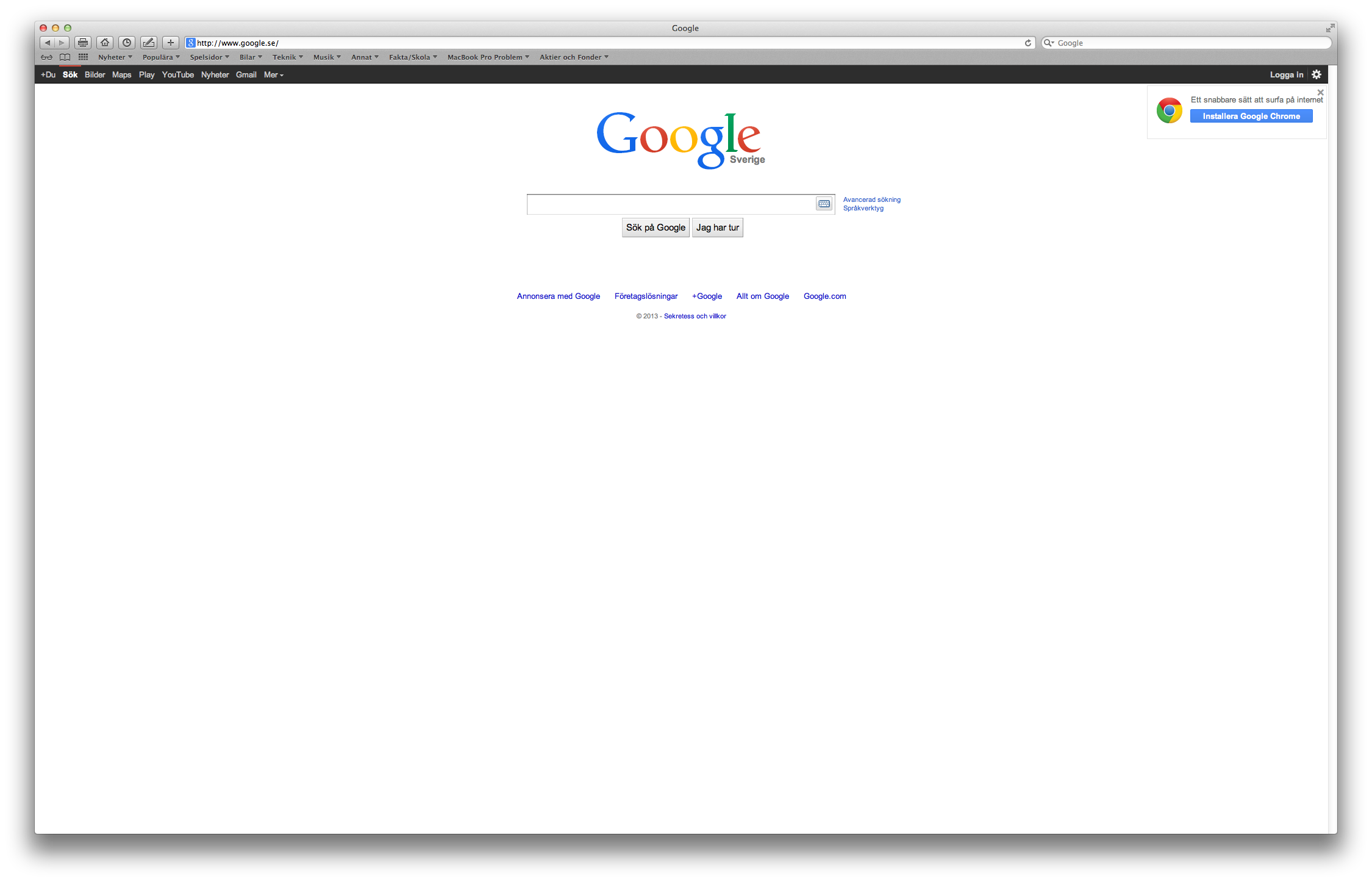

My problem now is that google doesn't look like normal. I googled the issue and all I got was that some IE11-users on windows 8.1 were getting the same problem and they called it "google legacy mode". Also if you click on the image thumbnails in image search, you don't get the usual preview, you go directly to the site where the image is located.

I attached a screenshot of how it looks.
EDIT: Now it seems that more people are getting the same problem, and not just in safari on mac. Safari on windows and opera have the same problem. So then it has nothing to do with the reinstall.
I had the same problem. I have multiple MACs and the problem only occurred on my Safari 5.1.10 system.
Changing the user agent to one of my other systems that worked ok fixed the problem. So Google is doing something on purpose with Safari 5.1.
Just change the Version to 6.0.2 and it magically changes

I've been running this system now with a bogus "Safari 6.0.2" version, and everything in Google seems to work fine. Maps, images, search results. So there probably isn't a very good reason to disrupt millions of people who are still using Snow Leopard. Certainly nothing that their army of engineers couldn't figure out if they wanted to. Some of the new street view stuff is a bit choppy, but its pretty choppy on a real 6.0 browser also.
