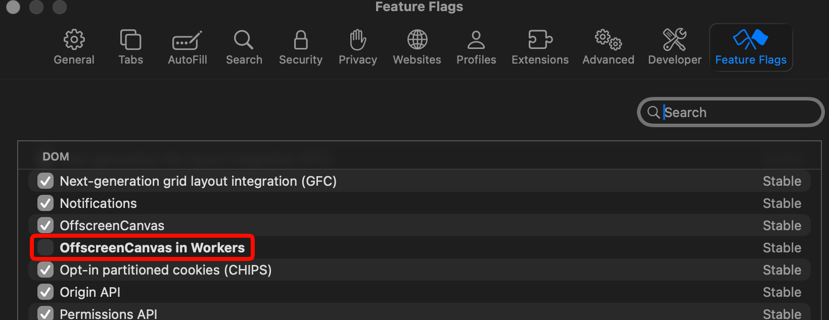

I had that same problem and might found the solution - disable "OffscreenCanvas in Workers" feature flag.
Confirming nmt1900's OffscreenCanvas flag lead — Tahoe flipped OffscreenCanvas-in-Workers to on-by-default in Safari 26, and Maps' vector-tile renderer hits a slow accelerated→CPU readback path when it does its willReadFrequently=false allocation for the label composite layer. Sequoia was still opt-in so it went through the older transferToImageBitmap path, which is why the M1 Max MBP under 15.7.7 is fine.
Two other levers worth trying on Tahoe if flipping that flag doesn't fully fix it — Develop menu > Experimental Features > WebGL via Metal toggled off (forces the legacy CoreAnimation path Maps' base tiles like better), and the fingerprinting-protection workaround Mischa43 mentioned works because that setting strips high-res timers, so Maps' internal frame-debounce isn't inflating from a coarsened performance.now().
Firefox stays smooth for the folks reporting no issue because Gecko doesn't gate its worker canvases behind the same GPUProcess handshake — different code path entirely.

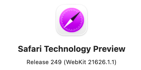

One more thing - it looks like this problem does not exist with Safari Technology Preview - even when that feature flag is left enabled
One more note on this issue - it looks like feature flags may reset after updates so it is good to check it over again if lag is back after updating.
