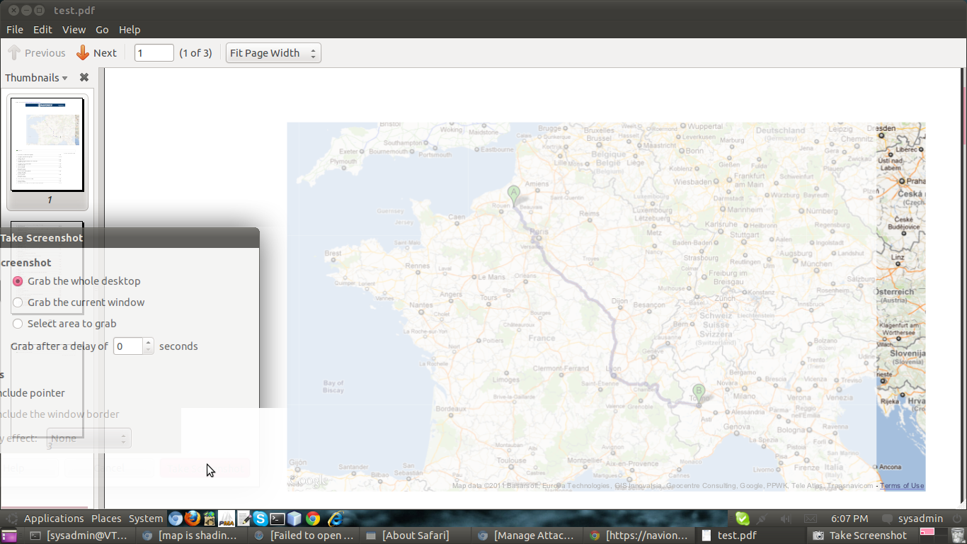

Hi ,
My safari version is 3.1.2.
In my rails application, i am printing the google map by using "window.print" . Its coming fine in other browsers. But safari printing the map(After clicking on print) with a shade over on it.
I have no idea to resolve it.
Please help.
Thanks,
Anu...
Hi ..
I found the solution for this.
There are so many JS files including in my page. From one of the javascript "lightwindow.js" which applying 0.7 opacity to the lightwindow overlay div.
So i have changed the 0.7 to 0.0. Problem solved.
Now the map is printing fine.
