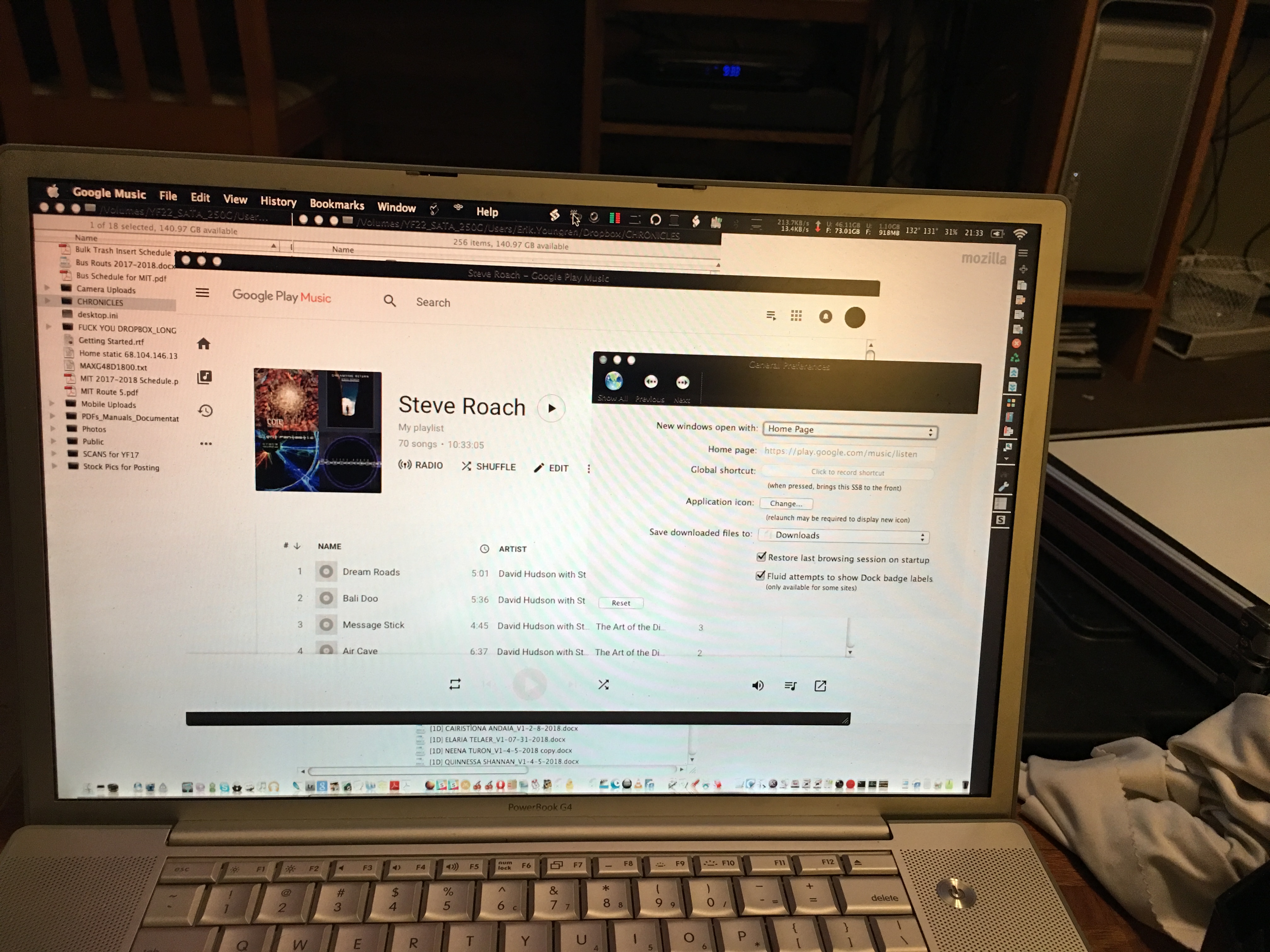

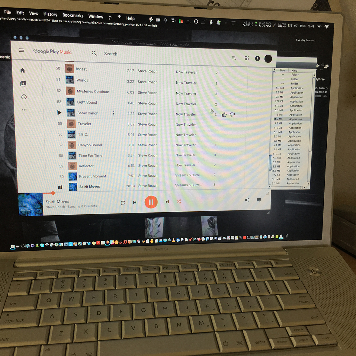

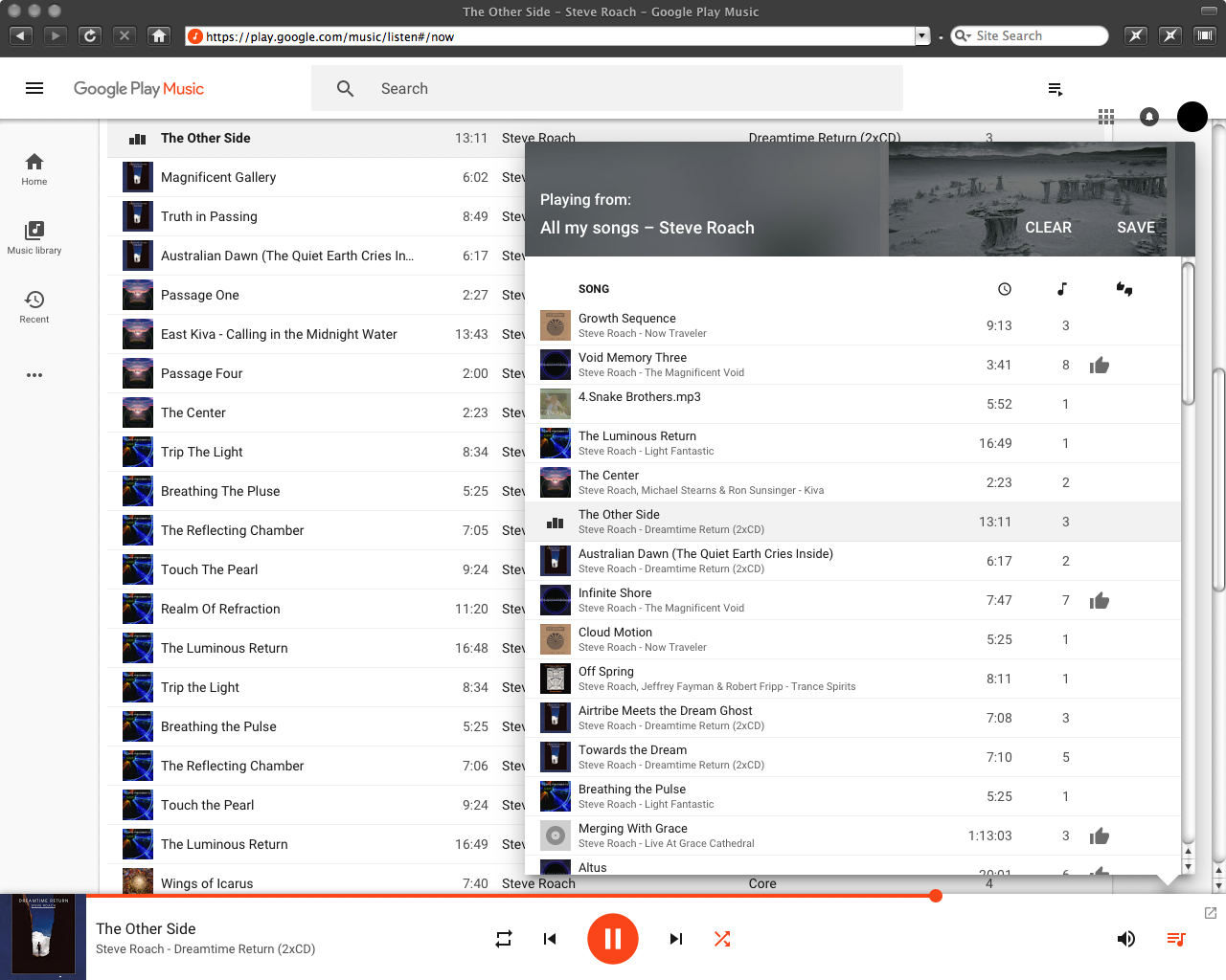

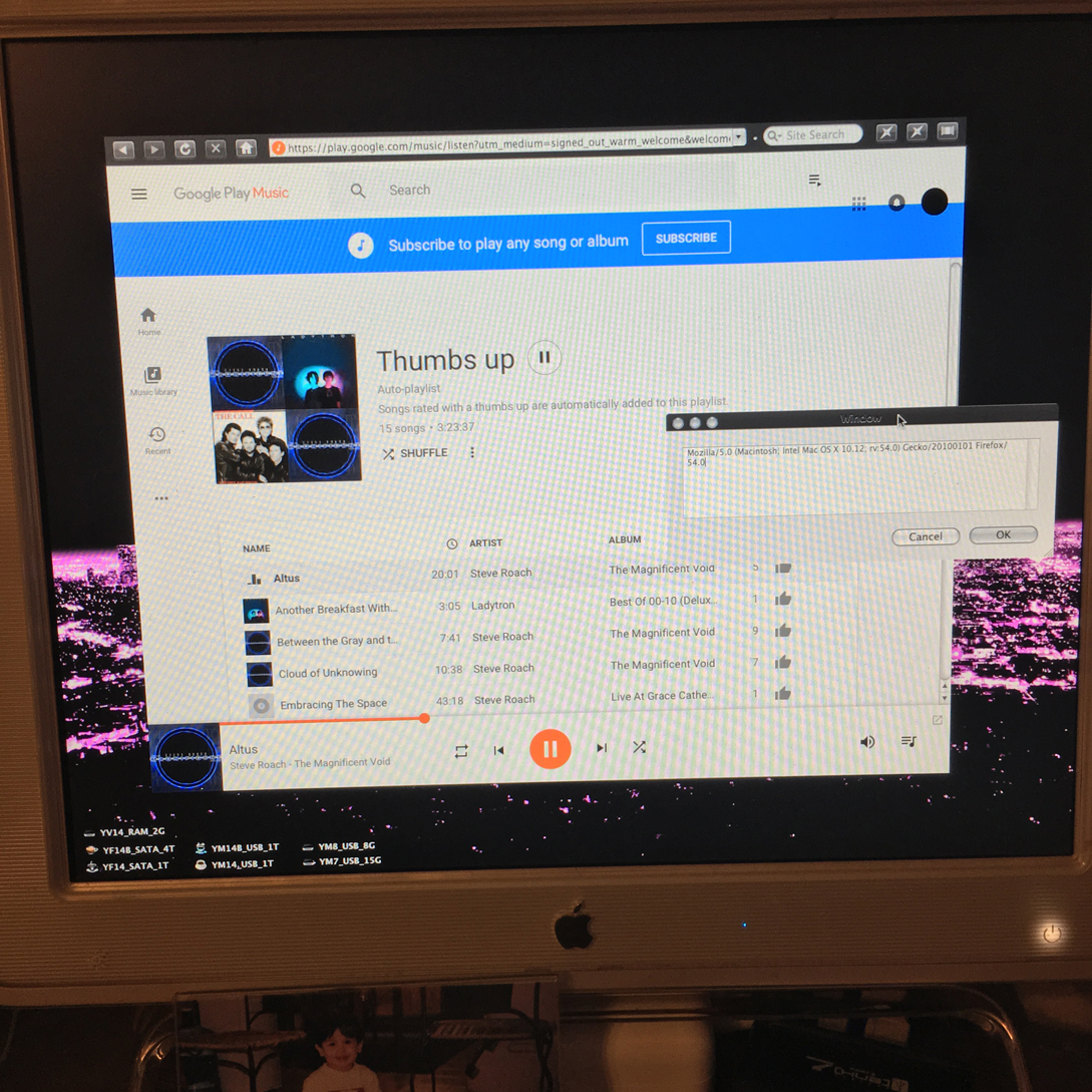

I had a thought today and I took a couple of apps created by Fluid 0.9.6 and I relinked them via Leopard Webkit. I gave them modern User Agent strings and they are working!!!
So, I thought I'd try Google Music again!
IT'S WORKING!!!!!!!!!! I am streaming Google Music from a Fluid instance on my Quad!!!!

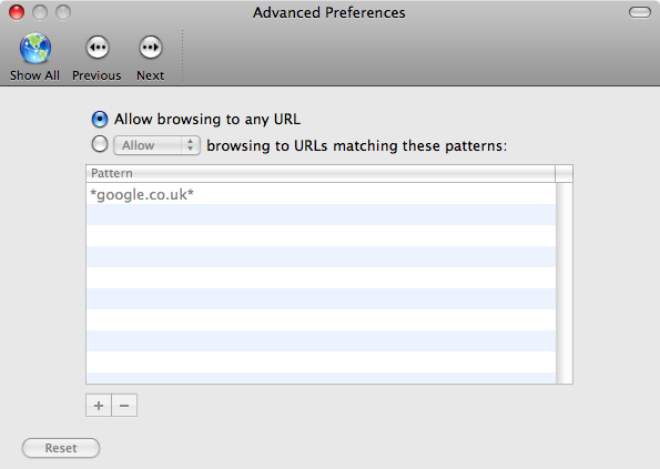

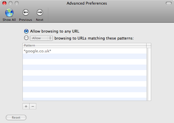

Hey so I downloaded fluid and webkit I updated the system certs and relinked the website app fluid made to webkit but the site still wont load am I missing something? Or how do I change the user agent as well.
You have Fluid 0.9.6? That's the last version that is PowerPC compatible.
You want to make the web app in Fluid. Then relink it via the LWK script. Do not delete the original app that relinking copies.
Once you open the new relinked app, give it a different user agent. I think earlier I gave it a Chrome user agent for an Intel Mac.
I cant get past the sign in page it just opens up TenFourFox.
When you create the initial web app in Fluid, is this the address you are entering?
