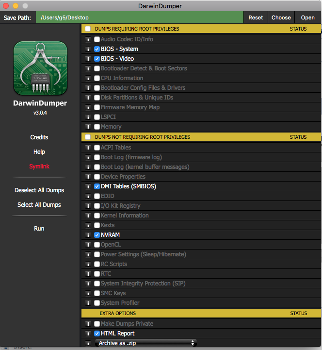

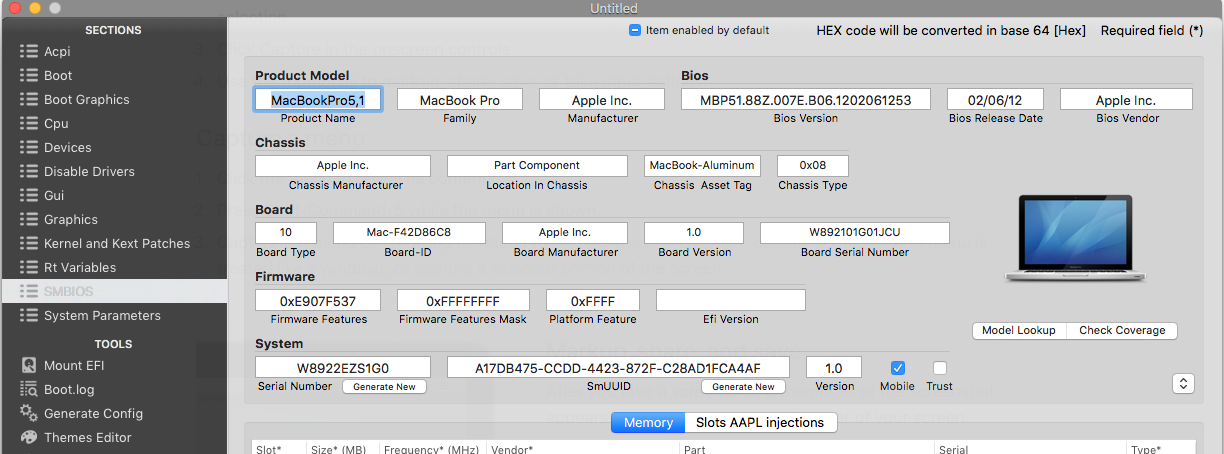

What I have noticed during the tests, there is a safe configuration for Clover:
In the SMBIOS section you need to select predefined MacPro 5,1 :
Download DarwinDumper: https://bitbucket.org/blackosx/darwindumper/downloads/
Select (SIP and Antivirus must be disabled)
Run the dump
In the DMI tables 1, 2 and 3 you will find (note I have selected private dumps, so the serials are hidden. For your purposes you should disable the private dumps):

Substitute the original values for the SMBIOS and RT- Variables page.
Disable all kext injection and tweaks in the other pages.
You may enable debug options in the BOOT page
Save the config file in the Clover folder.
If you leave the SMBIOS page empty (like I did in my last test) you may get NVRAM corruption.
Anyway it is recommended using Refind, Refit or Next Loader as they are designed for Mac unlike Clover.
