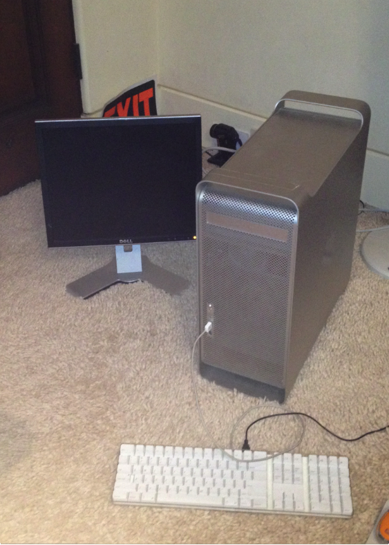

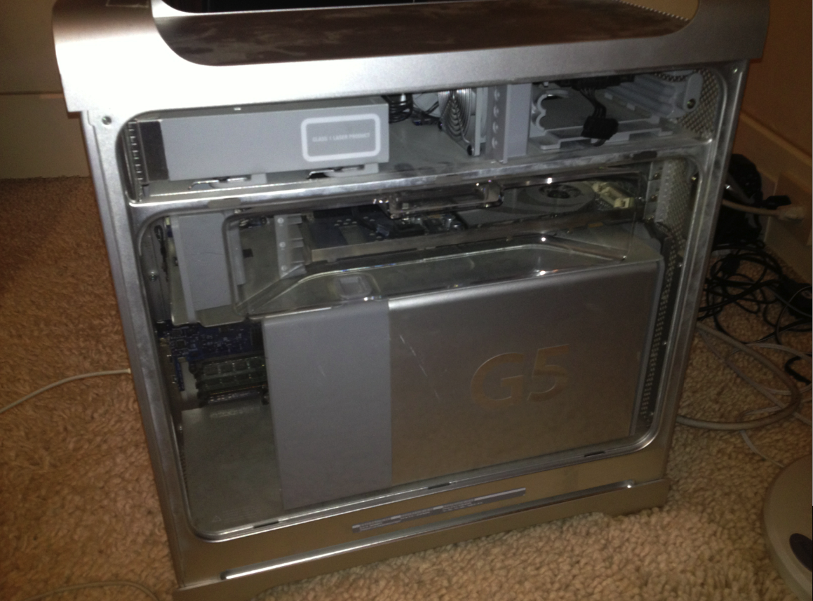

Ahhh, I am really happy about this. So I found a local seller (on Craigslist) who was selling this PMG5 Quad. I saw that it didn't list the specs and was $60. "It's probably a dual 1.8Ghz", I thought to myself. But, sure enough, it was a Quad-core G5! I gladly picked this thing up, and it came with a small (15") Dell Ultrasharp monitor (very versatile displays), and Apple keyboard.
I have yet to fiddle around with this thing, as it's 8:00 at night and I have work to do. However, I did get a chance to turn it on; it has a 500GB HD and 4GB RAM. It's definitely pretty speedy, as far as I tested it, but I noticed that the fans are constantly blasting... I presume I need to do a calibration test with this? Perhaps a PMU reset, or whatever it is? I removed the air baffle while it was running, and noticed NO change in fan volume, showing that they are already on full blast.
Besides all that, it seems to be in good shape, just pretty dirty. I noticed grain on the Dell monitor. Maybe something with it is out of whack, but its general picture is still sharp. I'll probably use it as a secondary screen anyway, considering it's so small.
Any help, tips, and/or suggestions will be GREATLY appreciated! 🙂
Here are some pictures of the beast... I gotta go through a whole day of school tomorrow before being able to mess with it.

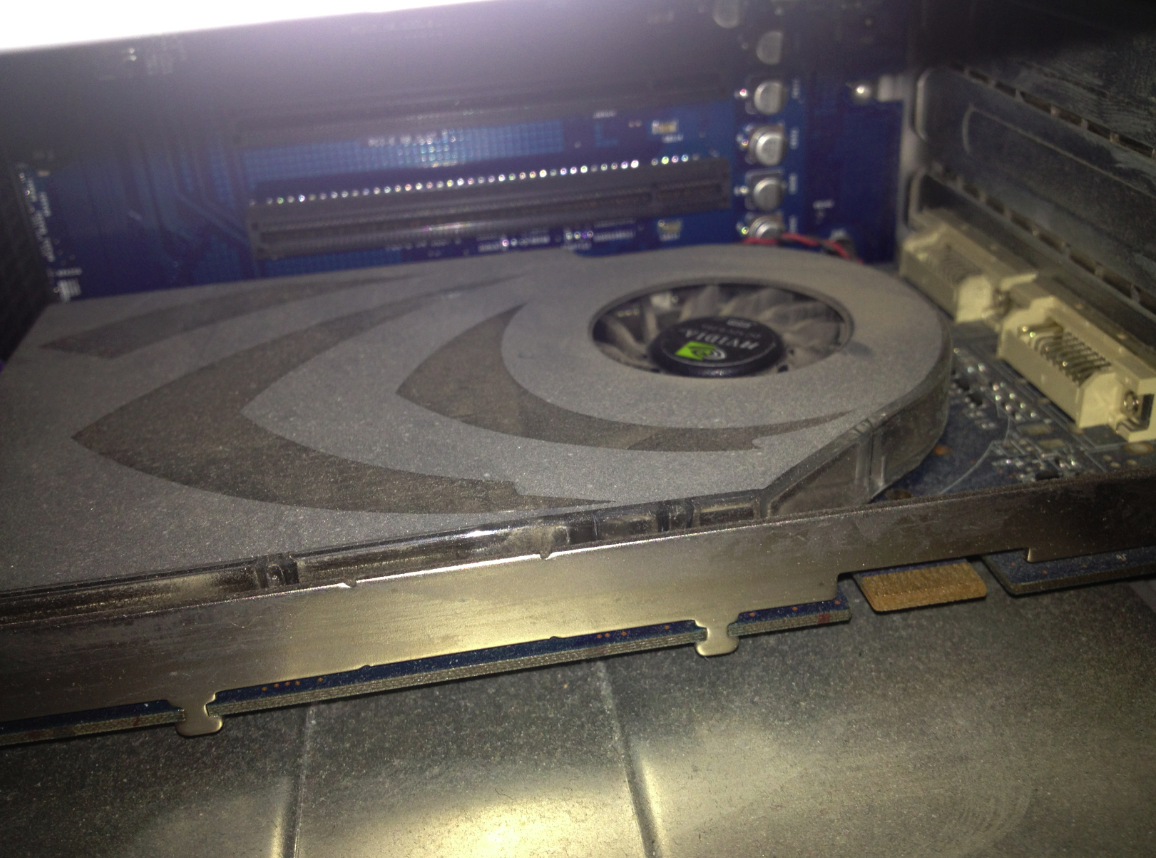

Outside, inside, and its Nvidia card. (Nvidia GT 7800, seems to be the 2nd best one that came w/ these)

The video card is a GeForce 6800GT. As for the fans, yeah it probably could benefit from the thermal calibration. The front CPU fans should be spinning, and since they're not, thats probably why the back fans are going all out. It may have a leak in the LCS, so I'd pop that cover off and check for corrosion.

I woke it up again and they were spinning... I think I need to do a calibration if anything. I really hope this thing isn't leaking. How do you safely remove the 'G5' plate? I have heard of many people breaking that little pin at the top. (also, I found out that it's a 7800GT, assuming it's the original one, as that is listed within the computer).
Haha, ya 6800 was a typo. Anyways, the pin on the cover will probably get damaged a bit when you take it out, but it'll still hold the cover in place. I've had mine off a couple times and it still does the job. It may not look as pretty, but it functions. The best way is to use an xacto knife edge to slowly work out the center rivet, then pull the surrounding part out. The plastic is pretty soft, so it takes a minute to do. Then slide the cover to the front of the computer and lift up.
I lifted the bottom part of the plate up and inspected (hadn't read your post prior). As far as I could see, there were no signs of leakage. Do you think a thermal calibration test can solve this issue? System Profiler says that all my CPUs are there, and I have found that all the fans are spinning now. The Mac is FULL of lint though, and it will definitely help once I get it cleaned out. I am just hoping this isn't something more serious. I have also found that the fans seem to climb higher once the computer is fully booted. They are sort of loud at the beginning, go down some, and then go up again to full blast once at the login screen, and constantly thereon.

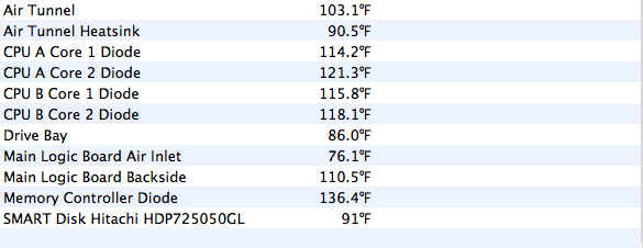

Cleaning the airways should make a massive impact. I'd also download Temperature Monitor and see if you've got any serious discrepancies between CPUs and cores. Some difference is to be expected (I've attached what mine is running at right now) so I wouldn't worry about a few degrees. Core 2 on CPU A seems to always run higher than the others for some reason, but it has never been a problem. I'd also blow out the PSU really good using an air compressor. The dust that collects in there can be insane. I don't have a 7800 in mine, but the X1900 fan blows like mad until the login screen, so you may also be getting some noise from that fan. It's probably dusty as heck too.
