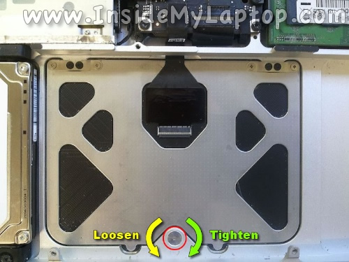

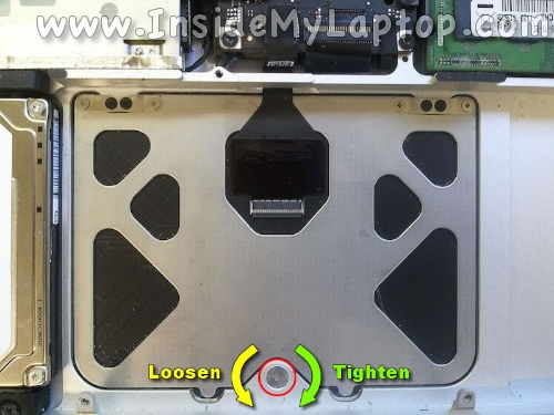

I think the centre screw in the trackpad can be turned to adjust its "click ability".
