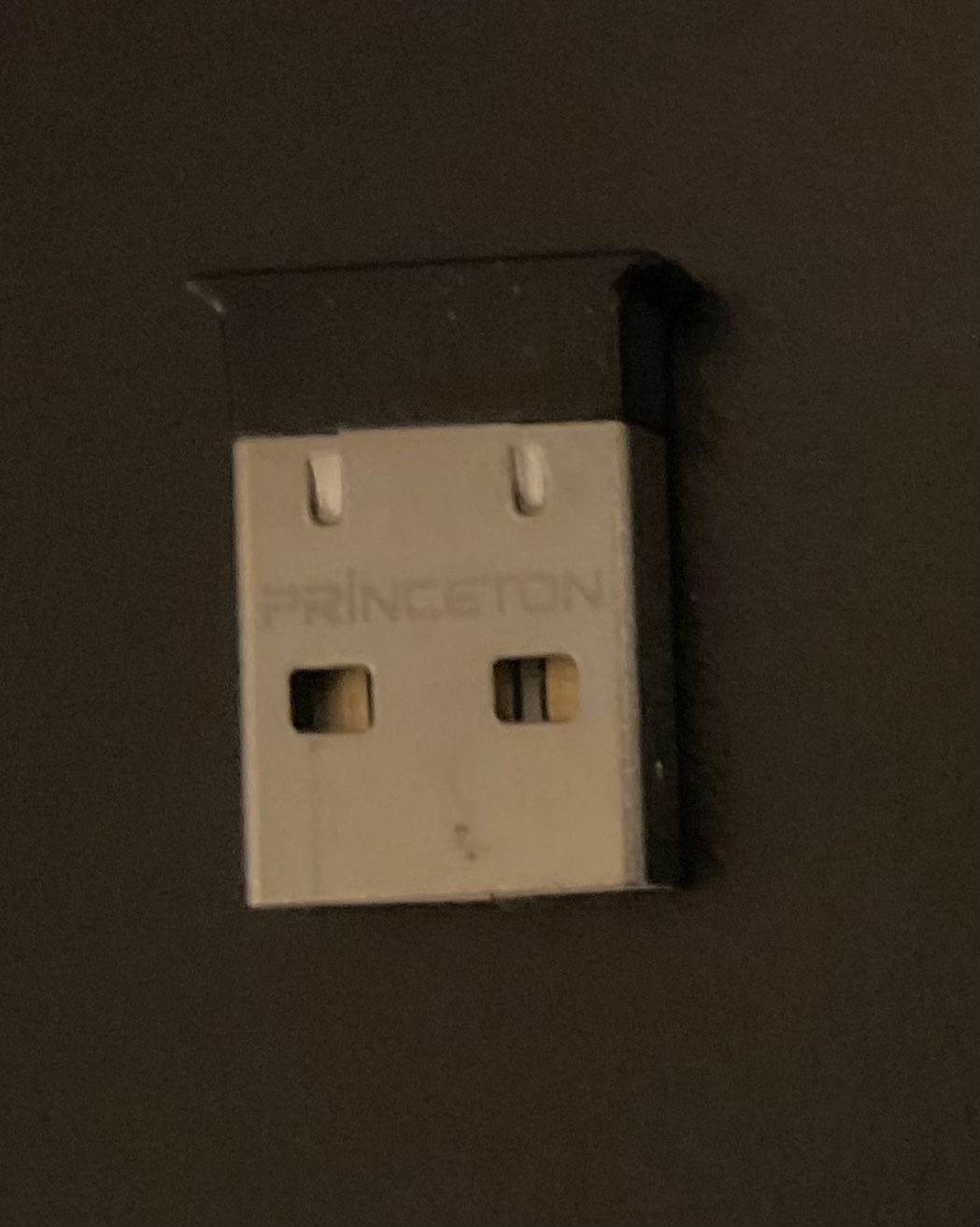

I had a 2011 MBP running the dosdude1 Catalina patcher, and I had handoff and continuity working.
to make this work, there were two things that I needed to do:
1) I got a Bluetooth 4.0 dongle that was compatible with macOS. The brand that I bought was Princeton. See attached.
2) I used some patches and tools provided by the very bright @jackluke. This user made some wonderful programs to enable continuity, airdrop, and handoff on certain macs within the Catalina patcher.
I reckon that you will at least need to upgrade your internal Bluetooth card, or get a 4.0 dongle. It’s much cheaper to get an external usb dongle. If you are going to replace the internal Bluetooth card, you might as well also upgrade the entire logic board to a 2012 board, if you open your computer up to do that.
In this case, Using a Dongle would be a cheaper and easy way than getting it repaired or replaced.
