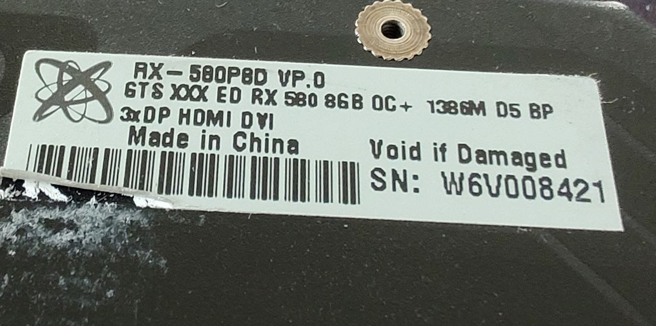

Thanks @tsialex . Please see the attachment. I can't determine which rom to download.
This seems to be a less common model:
RX - 580P8D VP.0
GTS XXX ED RX 580 8GB OC+ 1386M D5 BP
RX - 580P8D VP.0

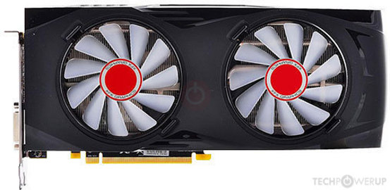

Searching for "RX - 580P8D" showed this one, start from it:

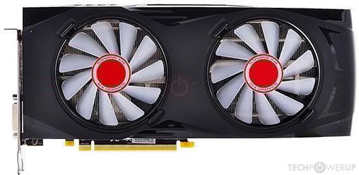

If won't work, try the one with 113-58085HADO-W90
If none above works, you will have to remove the heatsink and find the correct video RAM maker/model and test all XFX firmwares that support the GDDR model or send it back to the seller.
Good luck!
None worked. This is the only working rom i could find, but the pink boot screen issue persists. The memory is made by Hynix, according to the seller, which corresponds to the working rom details.

The issue was resolved by flashing this rom for RX 580 Sapphire Pulse. I tried this since it uses the same memory as my XFX card (Hynix H5GC8H24AJR) and it worked. Now boot loader screen is displayed correctly, no pink tint anymore.
